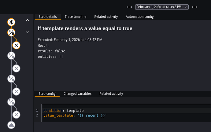

An automation that triggers but stops in the Conditions block still produces a Trace. Here’s one from an automation that stopped upon failing the first condition in the Conditions block:
