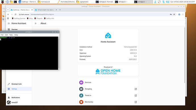

Having said that, the followup question was about browsers. It would also be nice to know what version of HA you are running.
I screenshot the thing from the bottom of Settings. I thought that updates had done 12.3 but it says 16.3
Home Assistant (HA) is on a Raspberry Pi 4, 64b, with 4GB memory

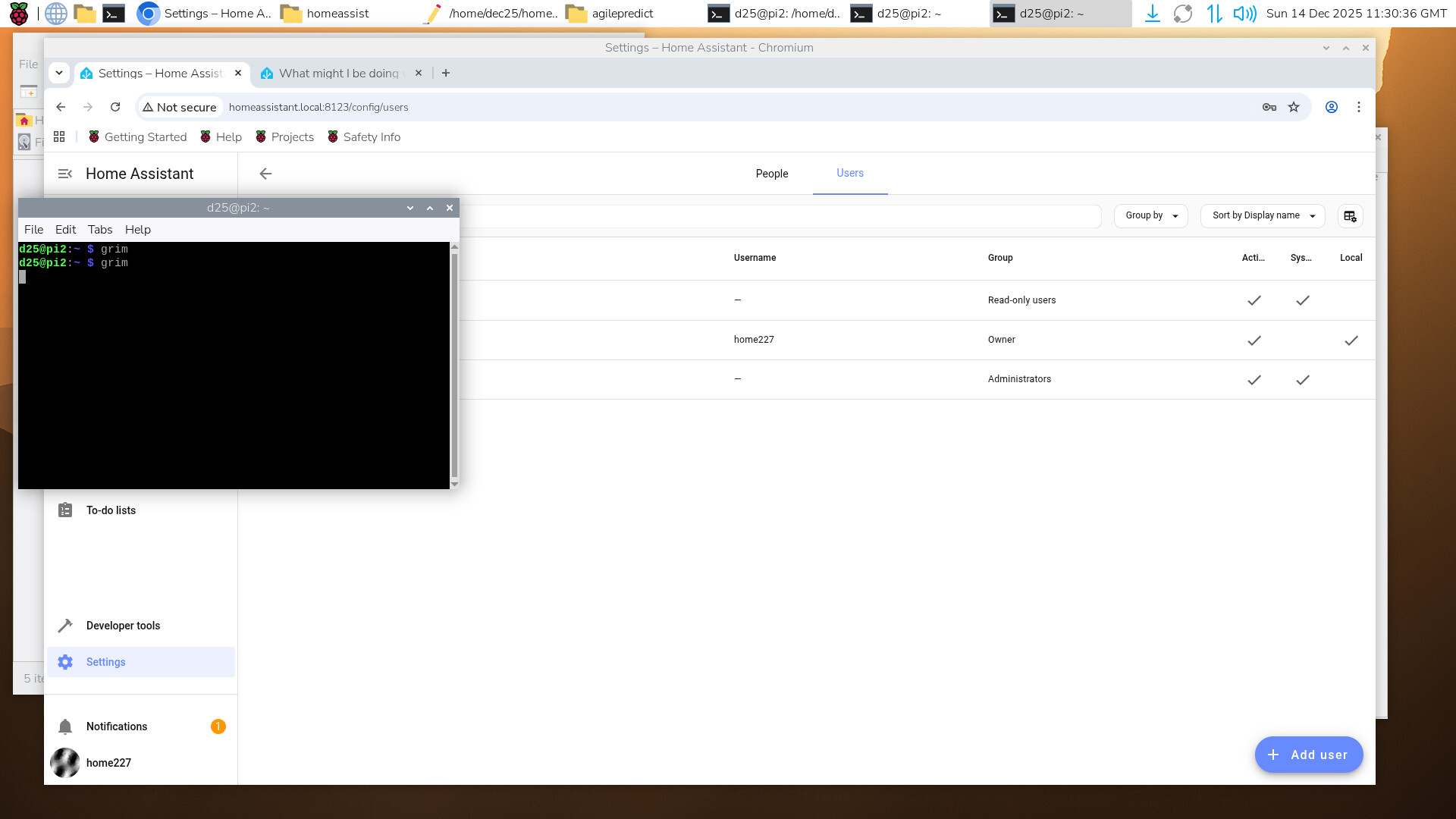

Might this be anything to do with my limitations ?
My default user doesn’t have permissions “Sys…”
No idea what those do. Before changing that, has anyone, ever, anywhere, got HA to create a script soon after a clean install without changing that ?
No the user rights have nothing to do with it, your user is owner and should be able to do what you want.
I think you can re-size the columns if you want to see what is written.
Thanks for comments that I shouldn’t need to change the “Sys…” permissions of default user-owner
