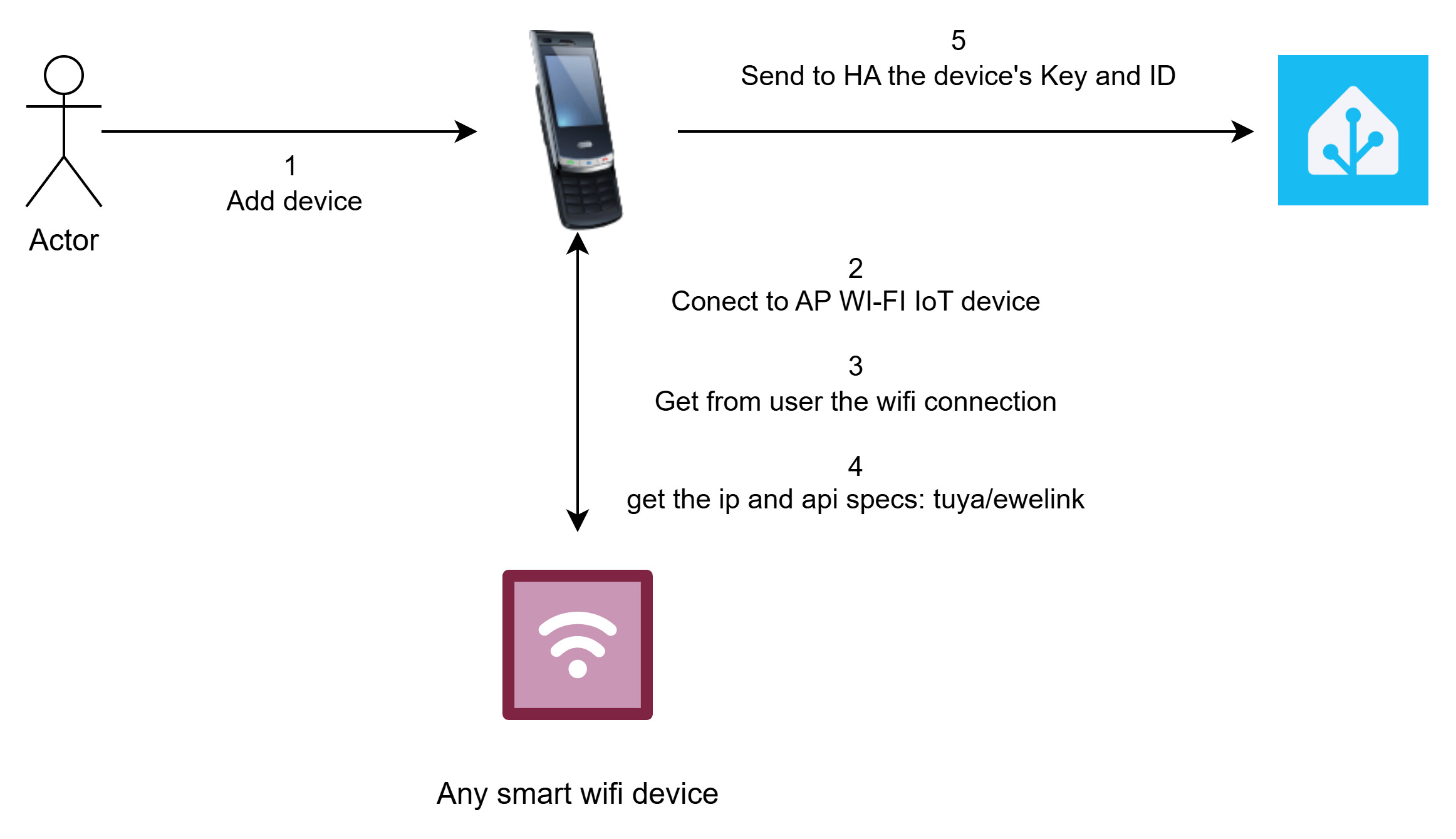

My question/interest is: why isn’t there, in the Home Assistant Android app, a process to add a device? Is the handshake process obscure, or is it not open?
Today we have this problem solved for Zigbee because you can use zigbee2mqtt. But for Wi‑Fi devices, setup using Tuya/Smart Life/eWeLink’s “add device” is mandatory—even if after the process you can run locally. So why not add the Wi‑Fi device and register Home Assistant as the “cloud” for the Wi‑Fi device?
My Home Assistant runs in Docker and has no access to Wi‑Fi. If a Wi‑Fi device—like a smart Wi‑Fi plug—connects to the same network, will Home Assistant be able to add it directly through the web interface without me needing to add it in the Tuya app for it to show up in the Tuya integration? As far as I know (and given the limitation of my Home Assistant setup), it can only be added using the Tuya app, and then it appears in the device list of the Tuya integration.

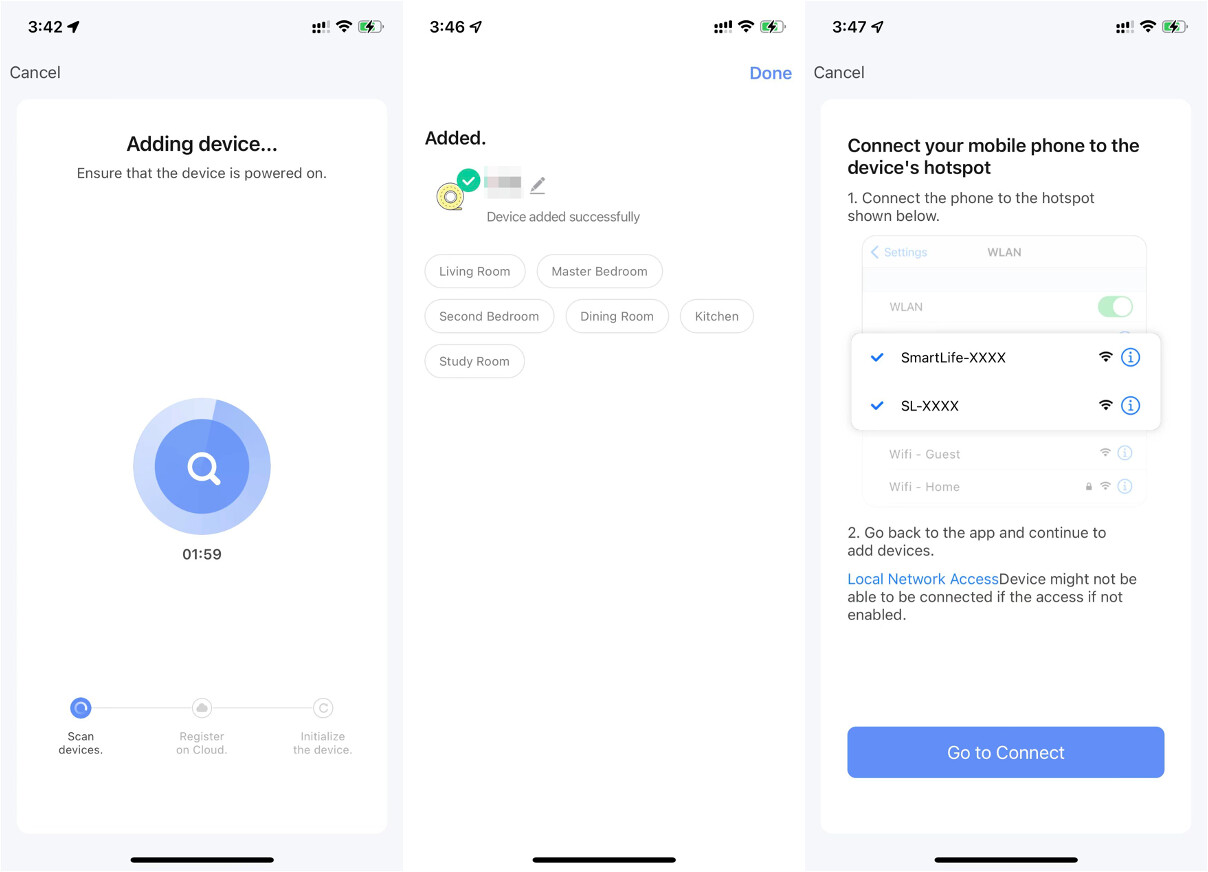

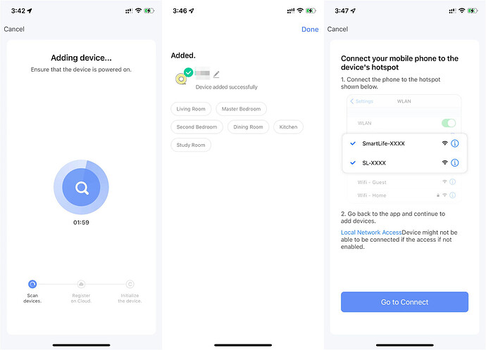

Step by step, for me to add a new Wi‑Fi device compatible with Tuya (but this also applies to Aqara, Sonoff, etc.):
For Tuya to find the device, besides providing an AP name, it must expose other discovery information. After that, the Tuya app accesses some endpoint that identifies/registers the device on the chosen network and connects it to the cloud. Why can’t this initial step for Wi‑Fi devices be available in the Home Assistant app and, for example, have a Wi‑Fi integration that supports some common protocols (does that exist?) for the Wi‑Fi device?

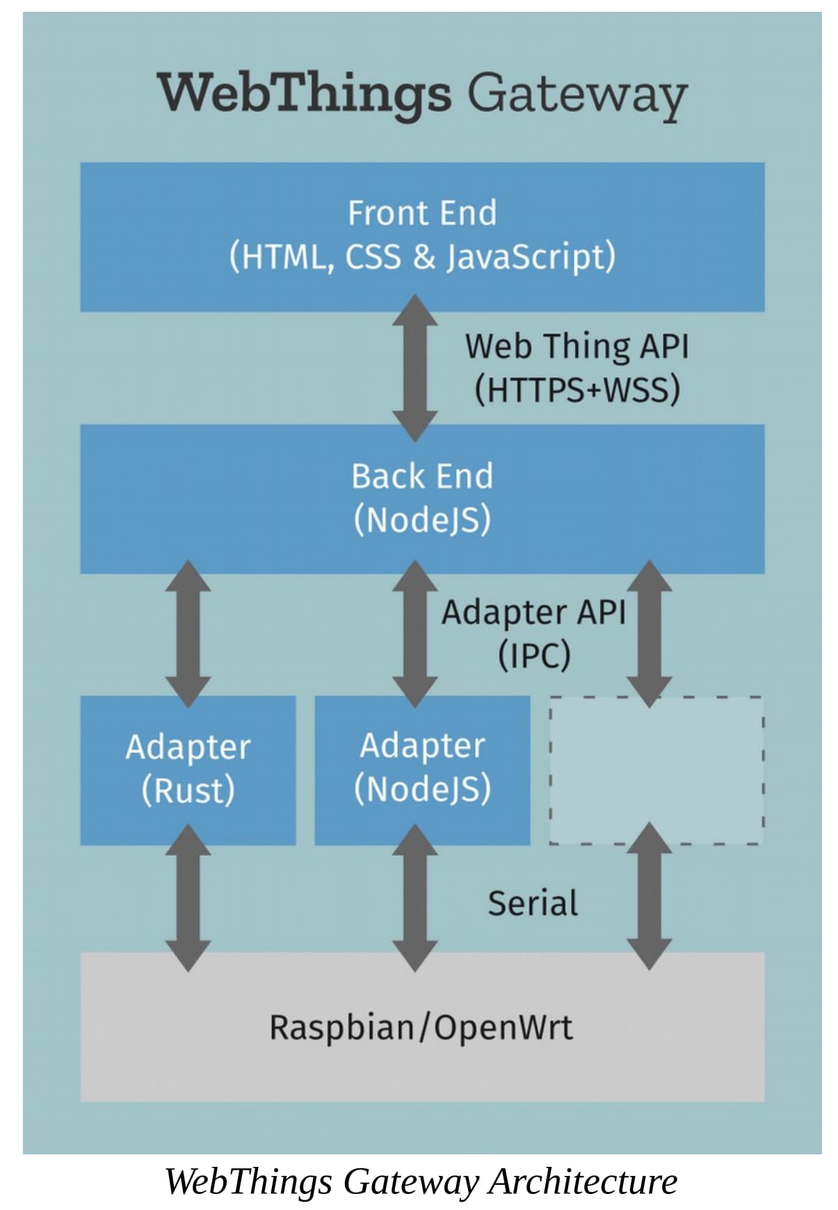

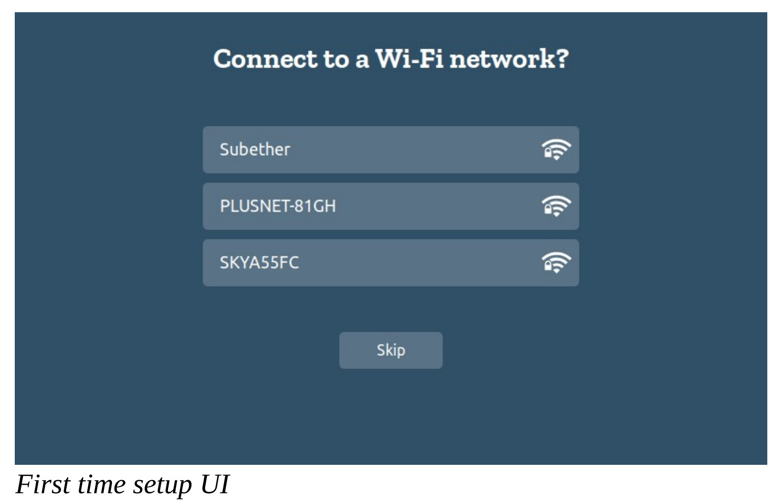

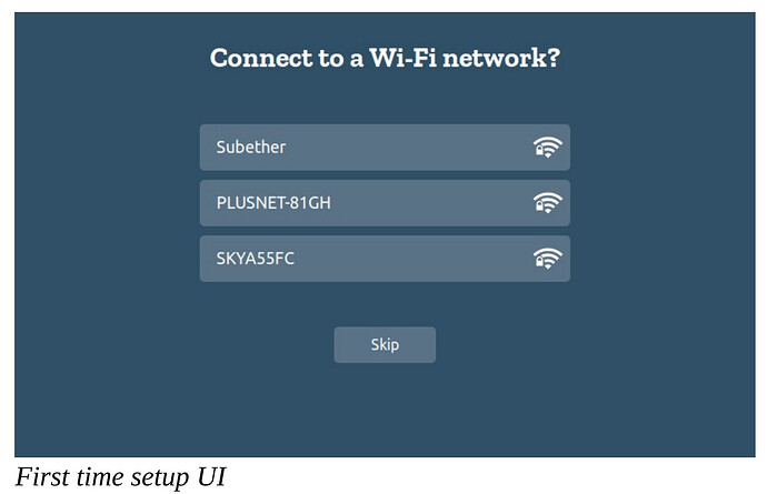

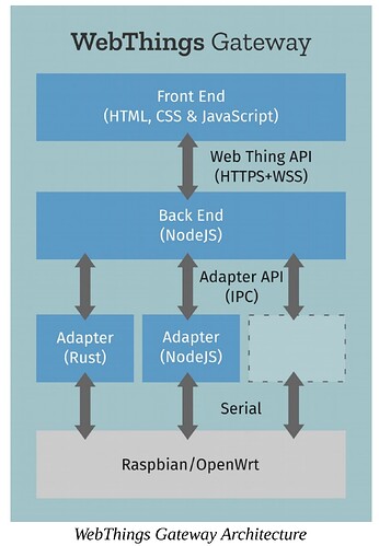

For future reference Mozilla WebThings allow something similar.

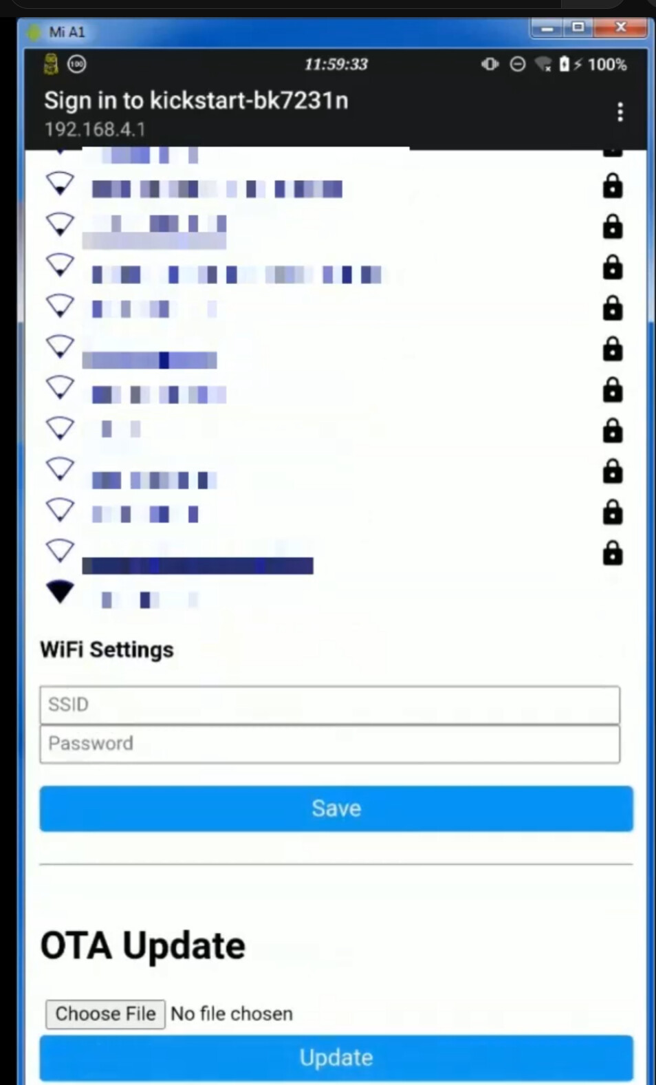

For wifi devices the guide of orange-assistant is correct, you need to flash a new firmware for every wifi device you have to allow using mqtt or the socket like ESPHome.
Ref.: BK7231 ESPHome/LibreTiny + Tuya-Cloudcutter - tutorial - Cloud-free, firmware for Home Assistant

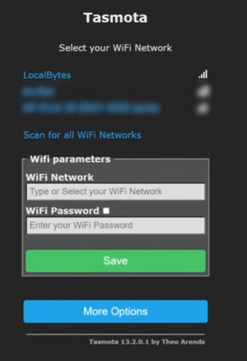

For tasmota
ref.: Getting started with Tasmota & Home Assistant
