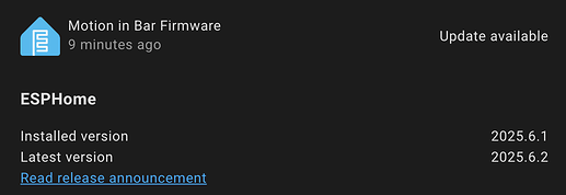

I update ESPHome Device Builder when prompted by HA. Afterwards I’m always prompted to update the same two of my ten ESPHome devices.
Is there a way to see what is triggering the update for just those devices?
Here’s one device that I always get prompted to update.

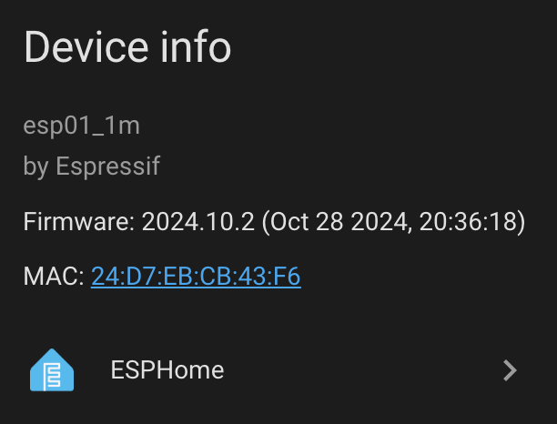

And here’s a device with older version that I’m not asked to update.

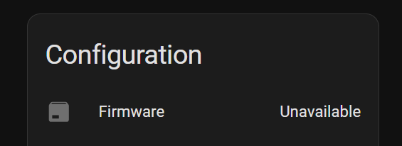

The difference might not necessarily be in the yaml.
Go to the device page in HA and check whether the update.yourdevice_firmware is disabled or hidden in the Configuration section of that page.
Yes, that was it. Thanks.
I do not remember disabling (or enabling) that entity. Maybe something related to when that device was first added? Or just bad memory on my part…
