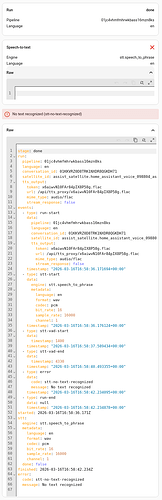

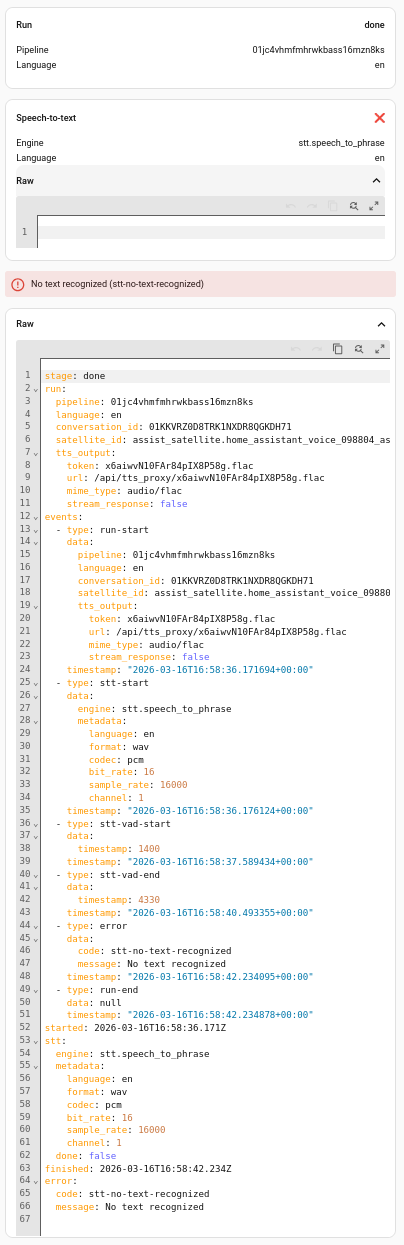

Use the debug view of the Assist pipeline that you’re using.
@arturpragacz
I get:
As you can easily read yourself, it didn’t recognise the words you’ve said.
Yes, how do I approach that? I’m pretty new to this and I don’t understand what it can and what it can not listen for.
In other words, I would have thought that the Assist where I type in the words, would be the tool I could use to see if what I would say would be possible for it to listen to. How do I know which words it can hear and make sense of?
It should be able to listen for those words, it’s just not understanding you. It may be due to your accent, not speaking loud enough, or whatever other reason.
To make sure that that’s indeed your issue, you should try to use a cloud-based stt to see if that works correctly.

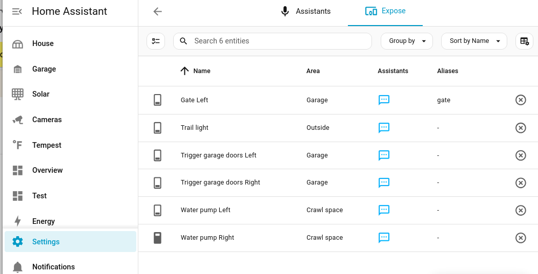

  4. Also in my case I have a dual momentary electrical relay device with a LEFT and RIGHT channel which electrically pulses the gate open/close trigger wires. This device name that causes the gate to trigger is thus called “GATE LEFT” (with a space in it). (The GATE RIGHT is not currently used.) But for whatever reason no matter how carefully I spoke “GATE LEFT” it could not be understood.
    The solution I found was to give ‘Gate Left’ an Alias. (go to: Settings | Voice Assistant | Expose).
    First I tried the alias “test”. Once I got that working (and settled down from the happy dance), I changed it to “Gate”. That did not work, even though I tested it many times. Then I changed it to “gate” (lower case), and that worked. Why? Strange.
    So I changed it back to “Gate” (capitalized) and every so often it would work. ??? I think the upper/lower case probably doesn’t matter. I suspect that perhaps ‘Gate left’ is getting confused with ‘Gate’, I don’t know. Or perhaps there is just too much noise or chaos.
Amazingly at this point speaking “OK NABU open gate left” worked. (I’m guessing it triggered on “OK NABU open gate” and ignored the trailing “left”. At this point I tried removing the “gate” alias, and it went back to failing all of the time. So in fact it seems to use the single work alias “gate”, and ignores extra words at the end.
