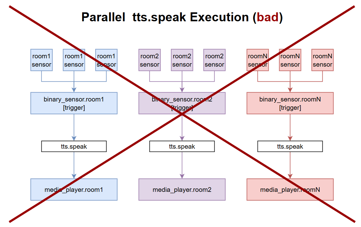

HOWEVER, I’ve run into a problem while thinking about the automation. I could easily write the automation with a big parallel block which issues several tts.speak commands, one for each room but that wouldn’t be great since I think the synchronization of all the speakers would be bad. I am figuring it would be better to build the automation to create a list of the rooms which have active occupancy and at the end of the automation issue a single tts.speak with the list of rooms. Something like this (with activity detected in the master bedroom, living room, and garage):

Here is a graphical description of what I described above. I can implement the “bad” one but I cannot figure out how to implement the “good” one.
For Sonos the HA core unwraps that into a series of service calls. So you are really not going to hear a difference between doing one call that targets two speakers and doing two calls that each target one speaker.
