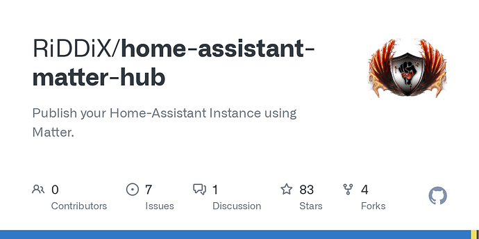

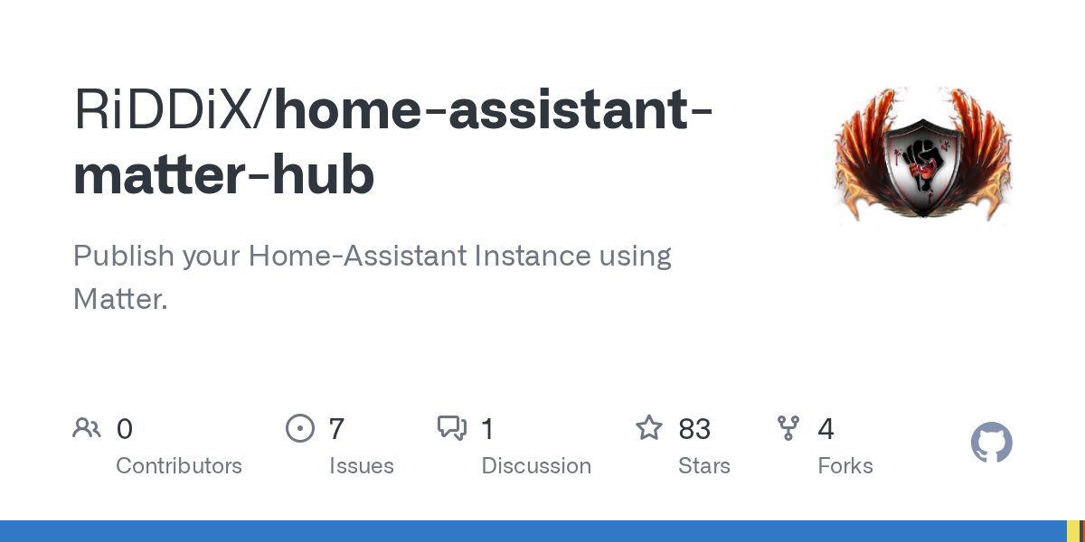

FYI, I came across a posting a day or two ago about a forked version that is being maintained:
Thanks!
I am impressed by the quantity of Issues the author of the forked repo has closed in the span of just 3 days.
The improvements are significant and the current alpha version (2.0) contains a feature I will definitely use: entity name customization (a.k.a. aliases).
The migration instructions are straightforward. I will make the switch when version 2.0 is released.
