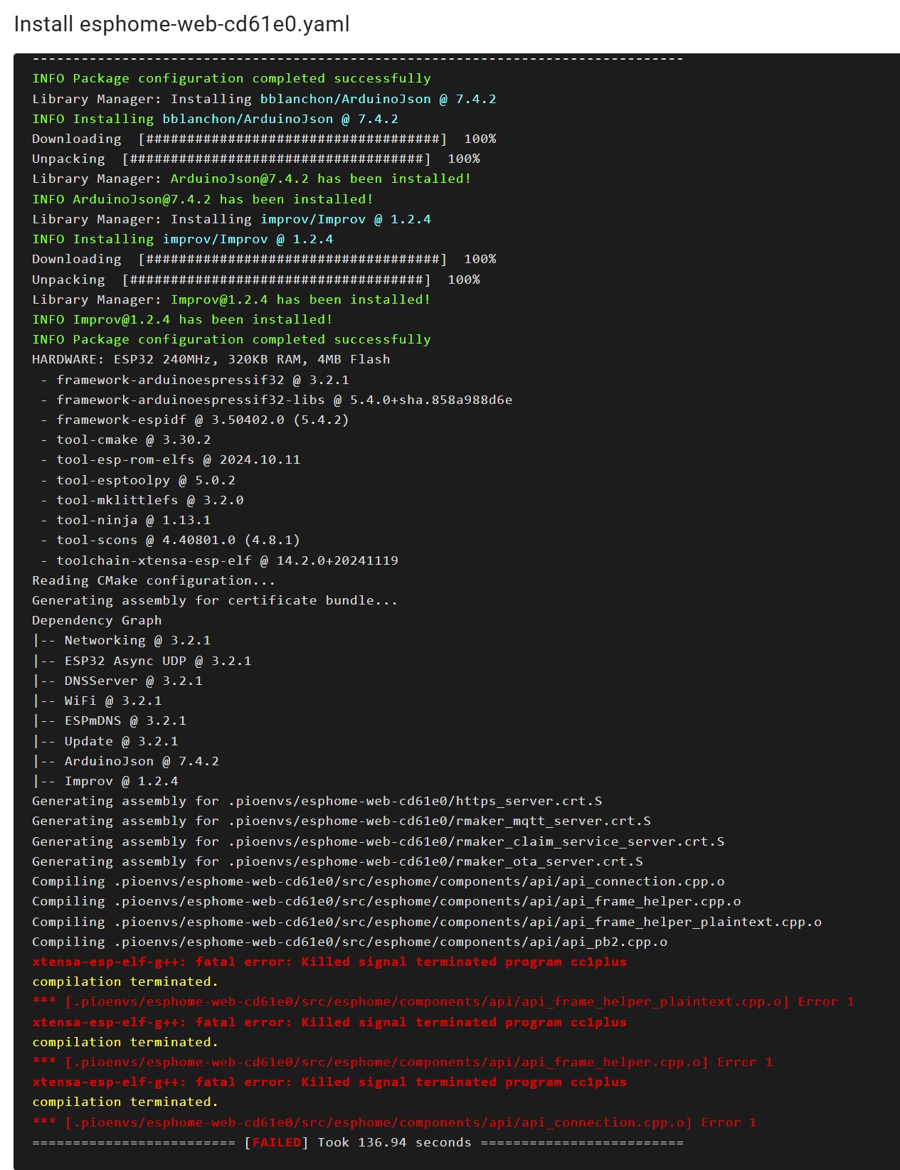

So let’s try to enter the log here:
INFO ESPHome 2025.10.1
INFO Reading configuration /config/esphome/esphome-web-cd61e0.yaml...
INFO Generating C++ source...
INFO Components removed (async_tcp, event_emitter), cleaning build files...
INFO Deleting /data/build/esphome-web-cd61e0/.pioenvs
INFO Deleting /data/build/esphome-web-cd61e0/.piolibdeps
INFO Deleting PlatformIO cache /data/cache/platformio/cache
INFO Compiling app...
Processing esphome-web-cd61e0 (board: esp32dev; framework: arduino, espidf; platform: https://github.com/pioarduino/platform-espressif32/releases/download/54.03.21-2/platform-espressif32.zip)
INFO Package configuration completed successfully
Library Manager: Installing bblanchon/ArduinoJson @ 7.4.2
INFO Installing bblanchon/ArduinoJson @ 7.4.2
Downloading  [####################################]  100%
Unpacking  [####################################]  100%
Library Manager: [email protected] has been installed!
INFO [email protected] has been installed!
Library Manager: Installing improv/Improv @ 1.2.4
INFO Installing improv/Improv @ 1.2.4
HARDWARE: ESP32 240MHz, 320KB RAM, 4MB Flash
 - framework-arduinoespressif32 @ 3.2.1
 - framework-arduinoespressif32-libs @ 5.4.0+sha.858a988d6e
 - framework-espidf @ 3.50402.0 (5.4.2)
 - tool-cmake @ 3.30.2
 - tool-esp-rom-elfs @ 2024.10.11
 - tool-esptoolpy @ 5.0.2
 - tool-mklittlefs @ 3.2.0
 - tool-ninja @ 1.13.1
 - tool-scons @ 4.40801.0 (4.8.1)
 - toolchain-xtensa-esp-elf @ 14.2.0+20241119
Reading CMake configuration...
Generating assembly for certificate bundle...
Dependency Graph
|-- Networking @ 3.2.1
|-- ESP32 Async UDP @ 3.2.1
|-- DNSServer @ 3.2.1
|-- WiFi @ 3.2.1
|-- ESPmDNS @ 3.2.1
|-- Update @ 3.2.1
|-- ArduinoJson @ 7.4.2
|-- Improv @ 1.2.4
Generating assembly for .pioenvs/esphome-web-cd61e0/https_server.crt.S
Generating assembly for .pioenvs/esphome-web-cd61e0/rmaker_mqtt_server.crt.S
Generating assembly for .pioenvs/esphome-web-cd61e0/rmaker_claim_service_server.crt.S
Generating assembly for .pioenvs/esphome-web-cd61e0/rmaker_ota_server.crt.S
Compiling .pioenvs/esphome-web-cd61e0/src/esphome/components/api/api_connection.cpp.o
Compiling .pioenvs/esphome-web-cd61e0/src/esphome/components/api/api_frame_helper.cpp.o
Compiling .pioenvs/esphome-web-cd61e0/src/esphome/components/api/api_frame_helper_plaintext.cpp.o
Compiling .pioenvs/esphome-web-cd61e0/src/esphome/components/api/api_pb2.cpp.o
xtensa-esp-elf-g++: fatal error: Killed signal terminated program cc1plus
compilation terminated.
*** [.pioenvs/esphome-web-cd61e0/src/esphome/components/api/api_frame_helper_plaintext.cpp.o] Error 1
*** [.pioenvs/esphome-web-cd61e0/src/esphome/components/api/api_frame_helper.cpp.o] Error 1
*** [.pioenvs/esphome-web-cd61e0/src/esphome/components/api/api_connection.cpp.o] Error 1
========================= [FAILED] Took 136.94 seconds =========================
So, all infos here now.

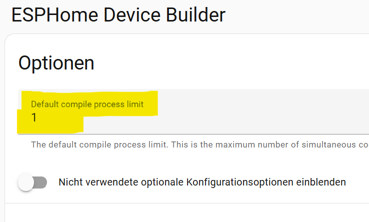

I was also thinking you might hit a memory limit. Can you check if you hit a limit/run out of it?
How much ram on your cm module ? The error comes most of the time from a lack of memory.
good question …
But I found a hint in the discussion referenced above, to set the process limit to 1 and now it runs slow but it runs.
Have to leave soon for holidays, but will report the results I get.
Thanks for helping so far.
With best regards
Gerhard
with this setting:
I am able to config my ESP32C6 Devkit.
