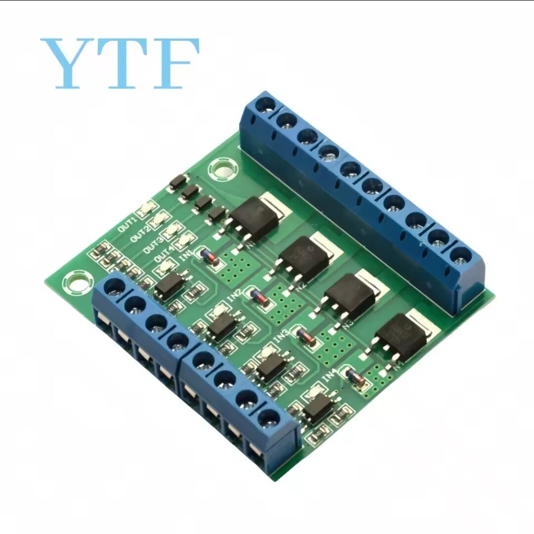

For some reason 4 channel seems to be the magic number unless you make your own. Single, double, or 4 channel are all I can ever find. I replaced my landscape lighting controller and ended up just stacking 4 channel boards together for a total of 12 channels. I’m kind of glad I did it this way now as it saved a lot of space over a long flat board with 22 channels. Most 4 channel boards come with mount holes, you just screw in stand offs between them and stack as many as you need.
What four channel boards did you end up using?
Any issues with flicker due to the soft PWM on these?

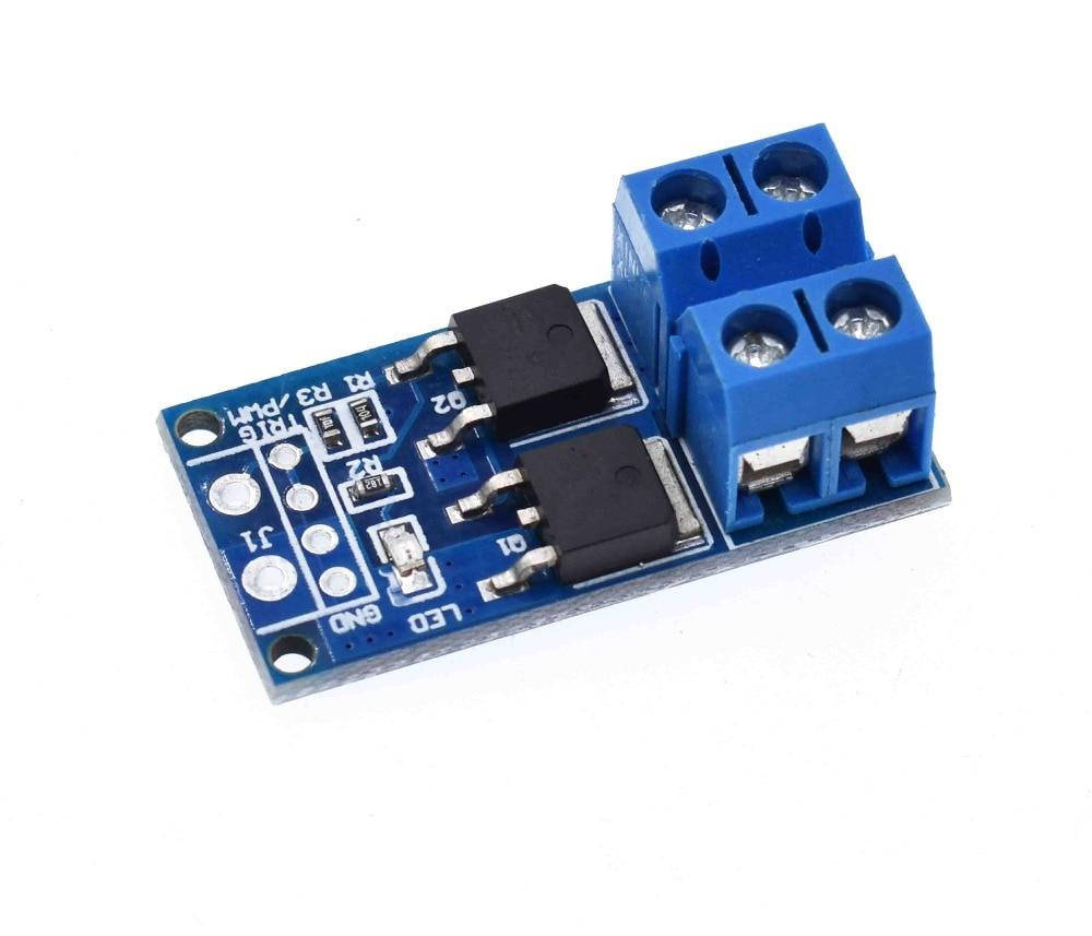

It’s also possible to build your own device very easily (and cheap) by using such blue break out boards the @system suggests ![]()
So 5 of this boards together with a esp32 and you got 5 channels ![]()
Mosfet modules are needed.
