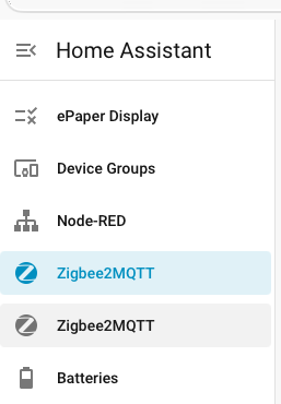

So now I have two zigbee2MQTTs in Home Assistant - anyway to rename to say z2m-Front and z2m-Back ? would make it it easier
Any input, much appreciated

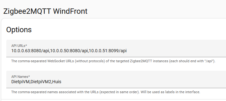

Why not use one front-end for both ?
Open Source frontend for Zigbee2MQTT
it is the new web-UI for Zigbee2mqtt, but can show/configure more then 1 zigbee2mqtt interface (I have 3 in it)

You just configure it in the add-on
First list is the URL’s, second the name shown in the UI

Up is the config for the stand-alone front-end

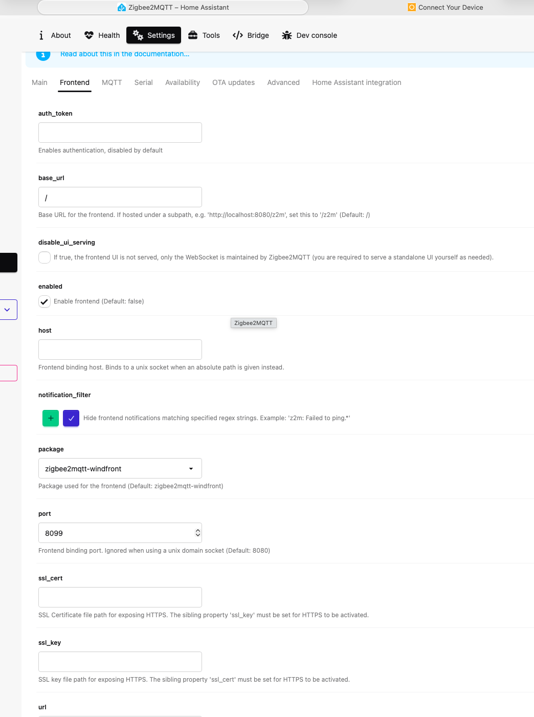

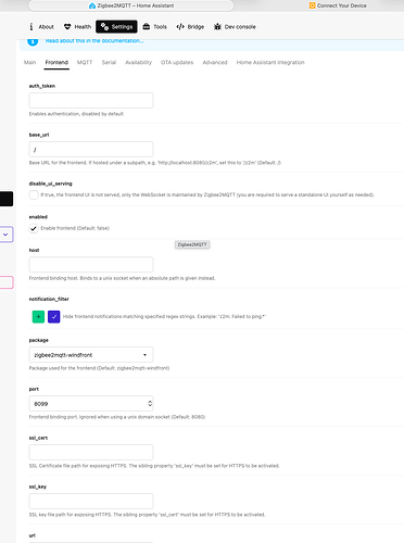

Ok I think I understand the issue.
I had been working on that WindFront was installed and operational according to zigbee2MQTT Settings/Frontend which shows package zigbeemqtt-windfront.
And if both zigbee2MQTT configuration.yaml contain
frontend:
enabled: true
package: zigbee2mqtt-windfront
The Frontend is not Windfront
Sorry in that case Windfront is not installed and I really appreciate your help here but I am lost.

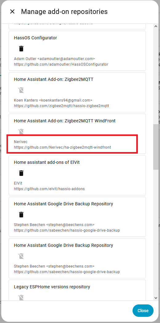

Second post in this topic. You need to add that repository to the add-on store, and then install the add-on
Busta999x
(Michael Horton)
December 10, 2025, 4:36pm
11
OK tried adding
and good luck
https://nerivec.github.io/zigbee2mqtt-windfront/
https://github.com/Nerivec/zigbee2mqtt-windfront is not a valid add-on repository
What am I missing here?

https://github.com/Nerivec/ha-zigbee2mqtt-windfront
Busta999x
(Michael Horton)
December 10, 2025, 4:52pm
17
Ok figured it out.
You can’t add that as a repository, you have to go to the link and select and follow the add on link, then it adds the repository then you can add it

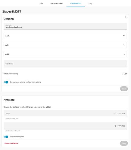

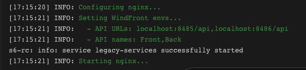

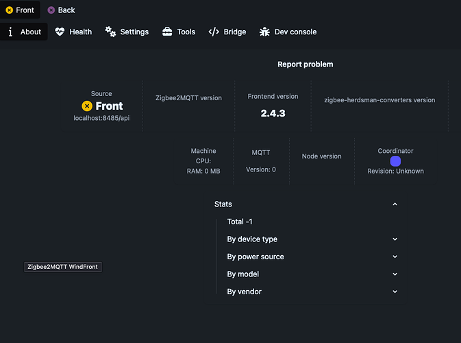

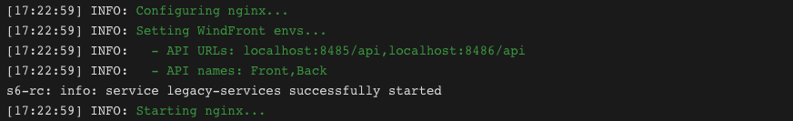

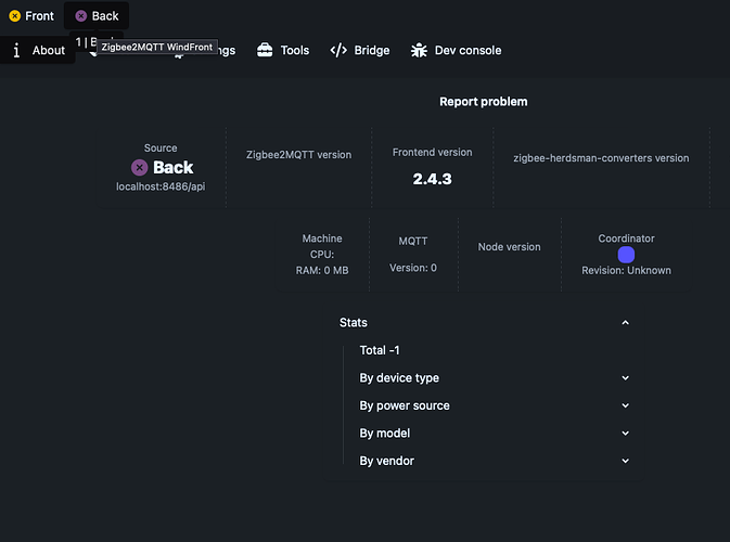

Ok installed new Windfront Add On
Configured it
Started WindFront as per Documentation
(should the zigbee2MQTT add ons be running or stopped)
I get this with them stopped
and with both z2m’s running I get
The only real noticeable difference is the zigbee devices are still working with zigbee2MQTTs running

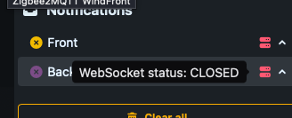

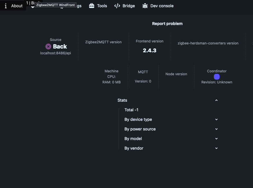

I am just seeing messages flashing
[Back} WebSocket: Reconnecting
[Front] Websocket: Reconnecting
Which indicates it is having an issue accessing the localhost?
Busta999x
(Michael Horton)
December 10, 2025, 5:33pm
20
Seeing this how to open the web sockets ?
