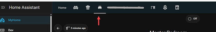

Hi, since the last few weeks when I move to a different area(tab) in the dashboard, HA automatically switches back to the default location after a few seconds.
When I select a different area(/tab):

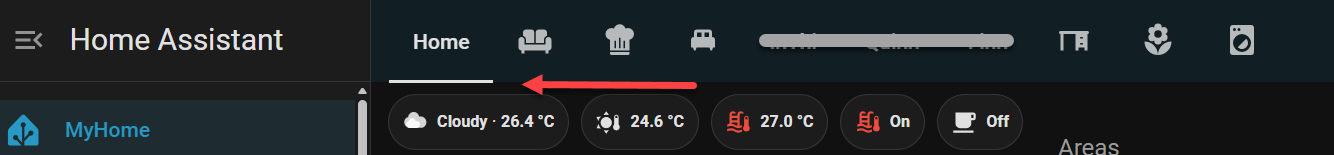

After a few seconds the dashboard will automatically switch back to “Home” which is the default:

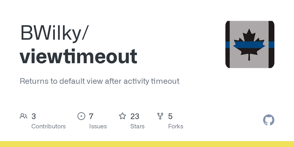

Can you elaborate what exactly was put back and to where?
Have no intention to entrap you, just as I said that “view_timeout” option is not present in Frontend code - may be it is a part of some custom plugin - like this one:
