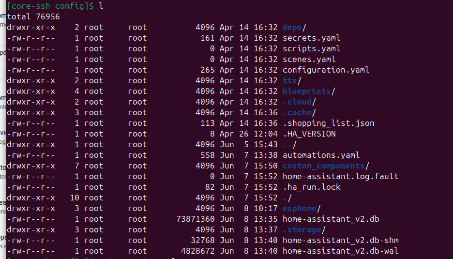

But when I log into root, I can only find this:
There is hardly any yaml in there other than including the other *.yaml files.

If you edited the configuration.yaml, 4th-file in your list, then this is where it is (it's the "real" And Only configuration.yaml ), if it was mend to create i.e entities, your find them in UI under entities.
