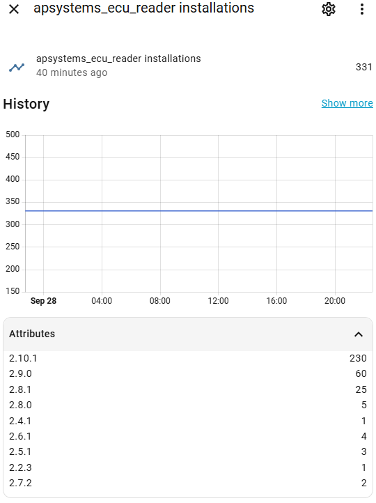

I used to get an immediate notification in the lower left of the dashboard when I drafted a new release. But that must be more than a year ago when that last happened.
Nowadays I can wait for hours before my HA instance is picking it up but only after browsing in HACS. Some users have noticed this too and from what I can tell the versions they are using are sometimes quite outdated.
How can I notify users for newer versions better @ludeeus?

From what I understand now is that from HACS 1.29+ the persistent notification was removed and HACS checks roughly once a day for updates or when you open HACS and do something there, mmm… I don’t know if that works fine taken the amount of different versions being used.
I could add a sensor with a persistent notification to the integration but that requires an internet connection, now it is without.
Are there any other options?
