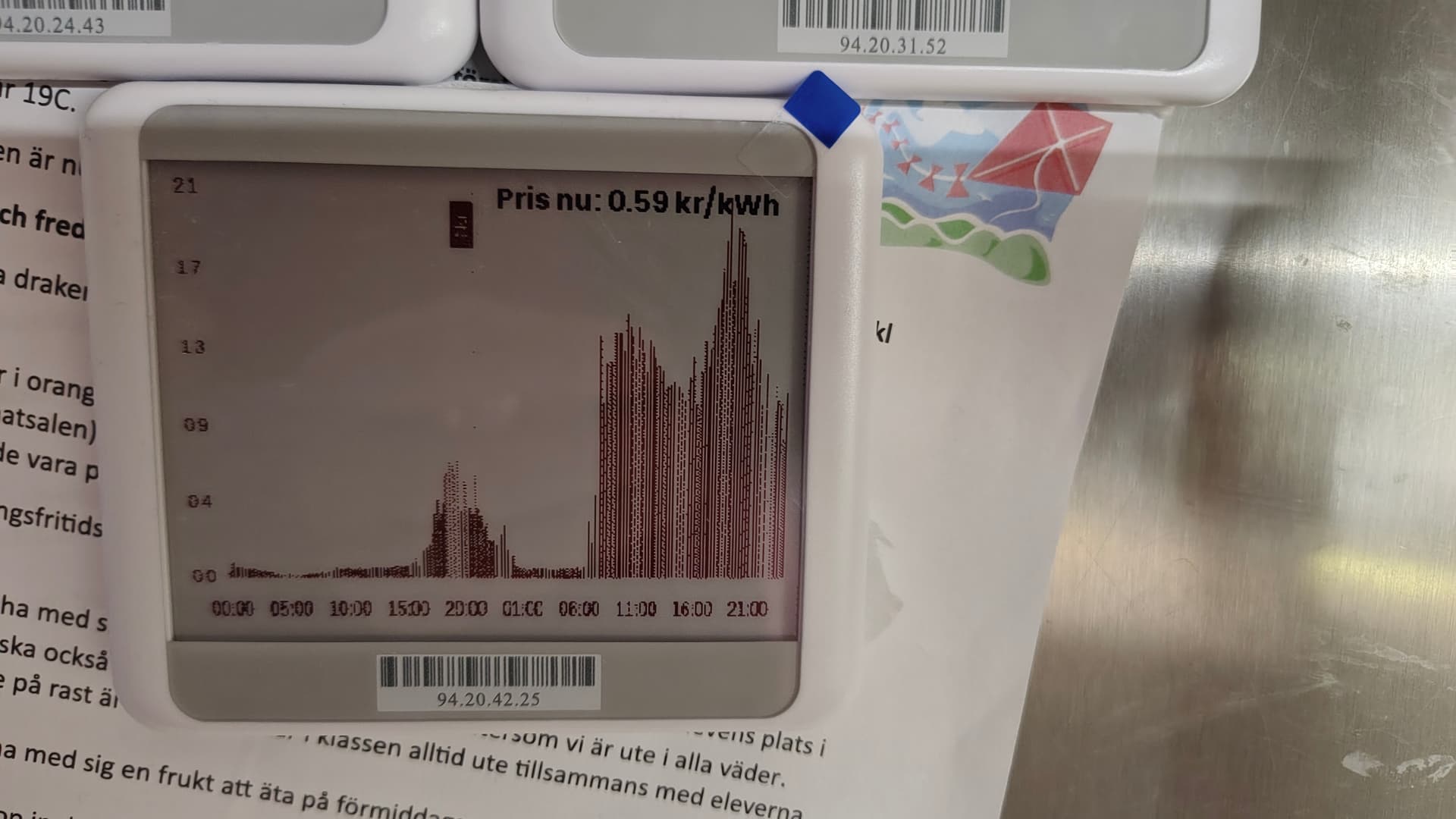

I use the nordpool integration from HACS and it has day ahead prices.
I display it with an apex chart and on ePaper tag, and it works fine
Thank you @Hellis81 . This works well indeed.
Clarification for others: the standard integration of Nord Pool does not contain this info at the moment, but the HACS version does. This resolves my confusion.
