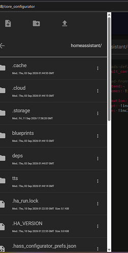

New installation and there is not /config folder. The one the has conf files is the /storage folder. Is this the correct location to put Quirk.py files?

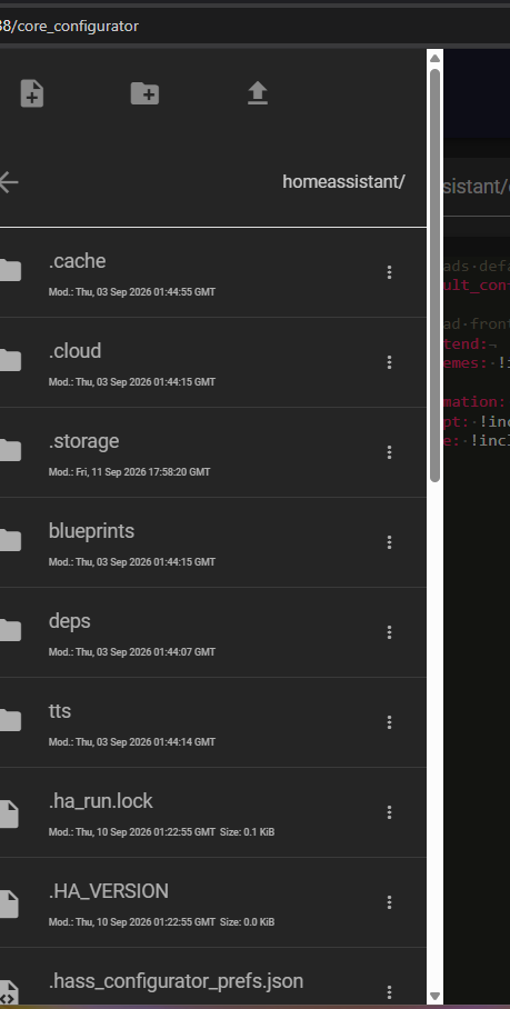

I believe you most likely have been confused by the " File Editor " App, Or by reading some none official(or confusing) Docs, referring to /config
I must admit, the Docs, starts out early with an attempt to “Confuse” People in this Doc :joy:
… Or maybe it’s the FileEditor
( Thou both “Paths” point to the same /homeassistant IS /config )

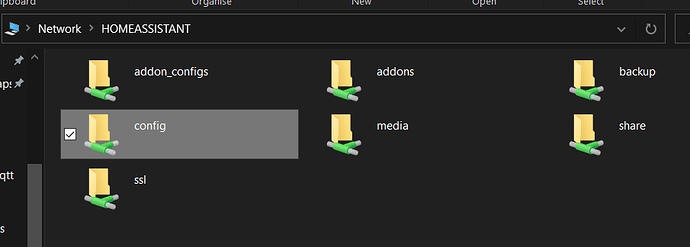

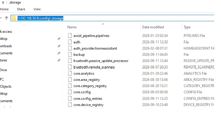

There is if you use Samba. File Editor simply renames this to /homeassistant for some reason
And if You use the ssh App, /Root ,you have symlinks /config and /homeassistant ( both points to same folder … And both point’s to /homeassistant

So tell me, does there exist a /config ? :grin: … yes outside the Container
And Btw, You are in the Samba Container (where You have a /config -link) :rofl:
The Name “HOMEASSISTANT” You see in your file-exploerer , Is Your Server Name
And btw network fileshare uses \ , as im sure you are aware :slight_smile:

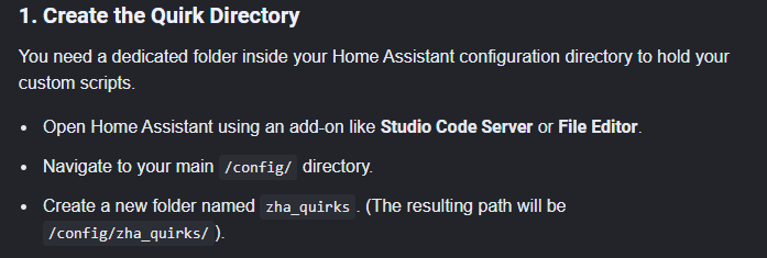

I’m simply trying to add a ZHA Quirk file per the below:
My File Editor shows this. Being new to HA, I’m reluctant to deviate from that I believe to be the proper unstructions.

Now that You know (i hope) then get on with your initial task, Create the “zha_quirks” folder, in /config … ( aka /homeassistant )
