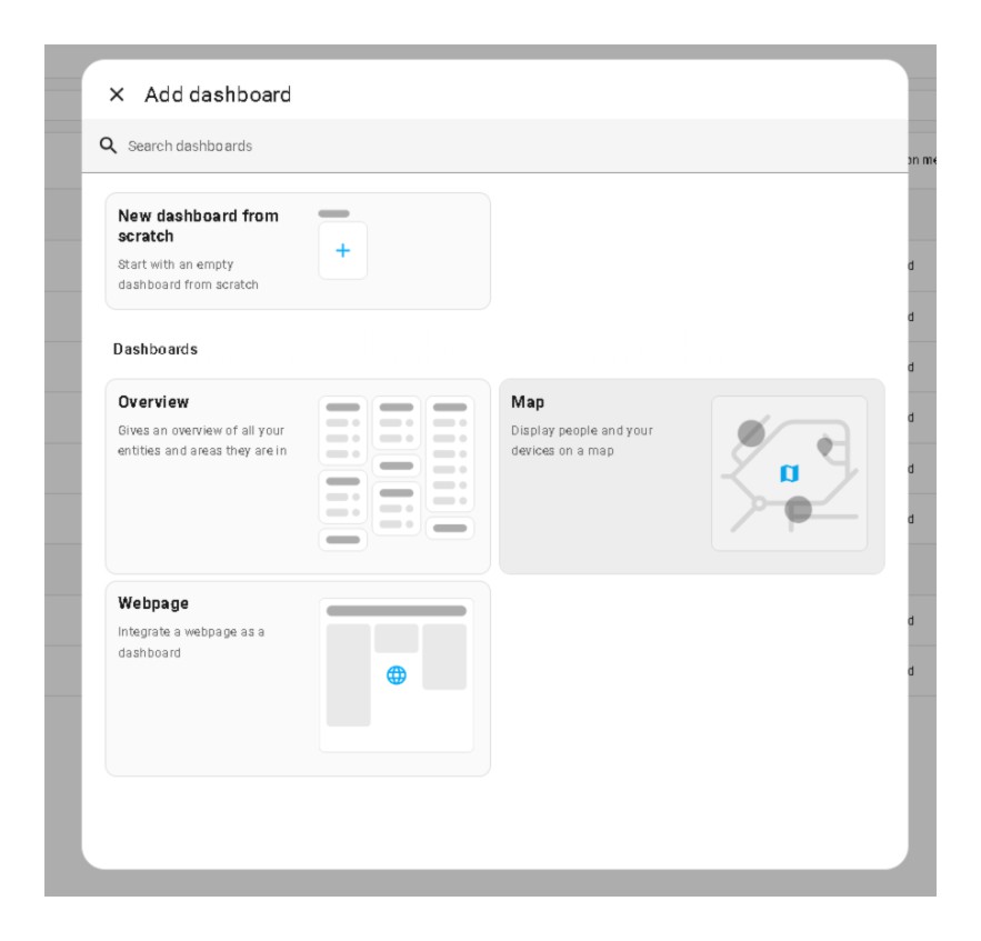

and I don’t see where to create a new home dashboard. it only shows 4 choice New from scratch, Overview, Map & webpage

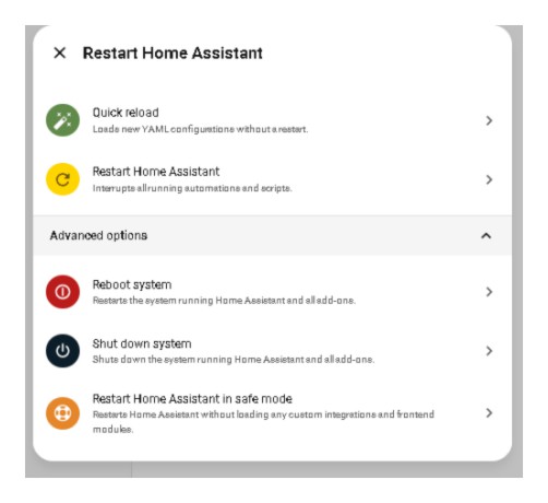

Just did a power cycle reboot and now see this
That’s a sure fire way to corrupt your database or disk. Use the Reboot Host option from the Developer Tools → YAML → Restart menu in future.

I used the system “reboot system”

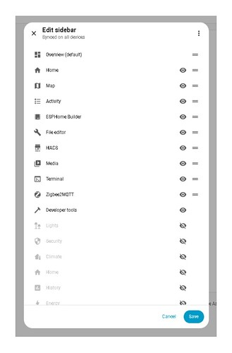

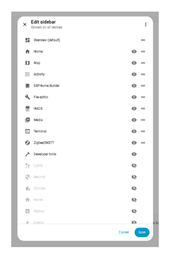

You don’t need to. They are already there. Built in by default. You just have to un-hide them by clicking on the crossed out eye icons:
when I click on them I get a whole lot of items in the side bar.
Seems it needs some sorting, should not be like this, before upgrade i could add another home dashboard and give it a new name for use on Tablet or mobile phone, thus having multiple home dashboards to work on

You can still do this. Go to Settings → Dashboards → Add a dashboard (button bottom right).
I only see these 4 dashboards to add
Oh I get it now. Sorry.
You’re expecting to be able to duplicate the built in Home Dashboard.
That’s not how this works. There is only one Home, Lights, Climate, etc dashboard. Like there is only one energy dashboard.
You can use the first option (New dashboard from scratch) to build whatever you want though.
