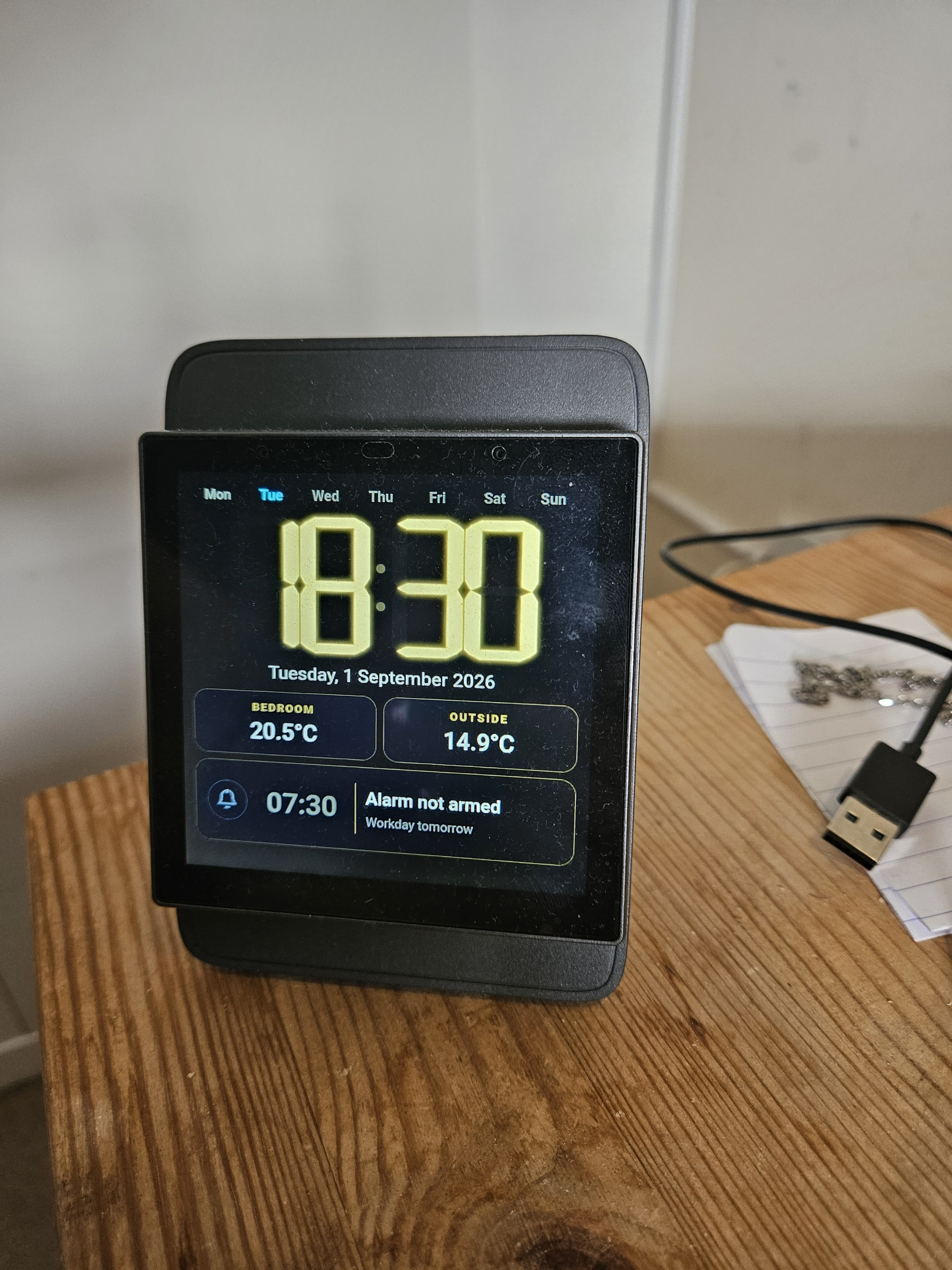

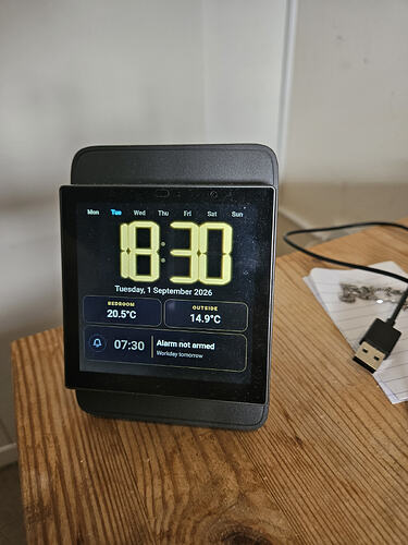

I created an alarm clock using an automation and a Home Assistant hosted html page that I pointed an old NS Panel Pro to. The NS Panel Pro is mounted in a desktop mount and powered from wall socket and now I have a Home Assistant powered bedside clock and alarm. My goodnight script then sets the right alarm time based on calendar entries.
