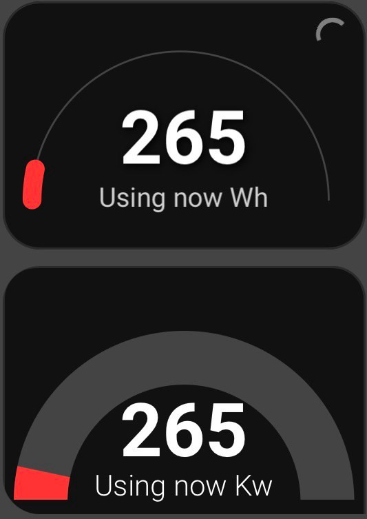

Which card type would you recommend
I have tried many different card types and made numerous adjustments, but I just can’t get it to look the way I want.
I would like a layout similar to the example below:
  • A thin border that fits nicely inside the card
  • Two cards next to each other (in mobile view)
  • Inside the card: the value displayed prominently, with a text label underneath
I managed to remove the thousands separator and replace it with a “K” instead (for example: 1124 = 1k1).

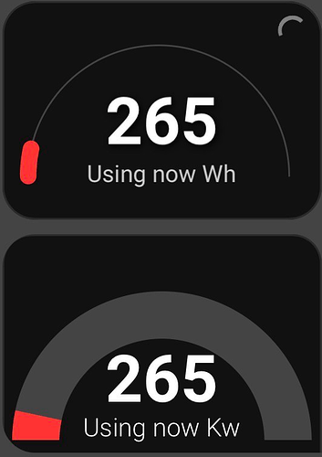

I have tried many different card types, but either:
( type: custom:apexcharts-card and type: custom:gauge-card-pro )
  • a spinning gear icon appears in the top right corner
  • the arc/border cannot be made thinner at all, or
Any suggestions on which card type would work best for this layout?
For the first one.
If you didn’t disable to show updating you get the update spinner, that simple.
As mentioned in the docs.
That didn´t work, I remember
loading: false

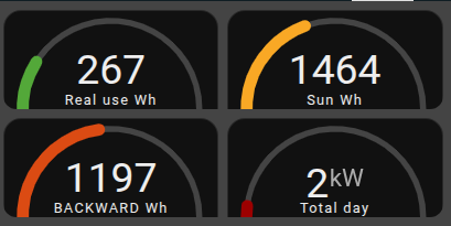

Now I have use the flex-horseshoe-card. It’s not finished yet; there will also be an arrow indicating whether the tariff is low or high, and whether the inverter is on or off, or starting up.
Instead of kW, I want to display the voltage (like I did before on my Rpi).

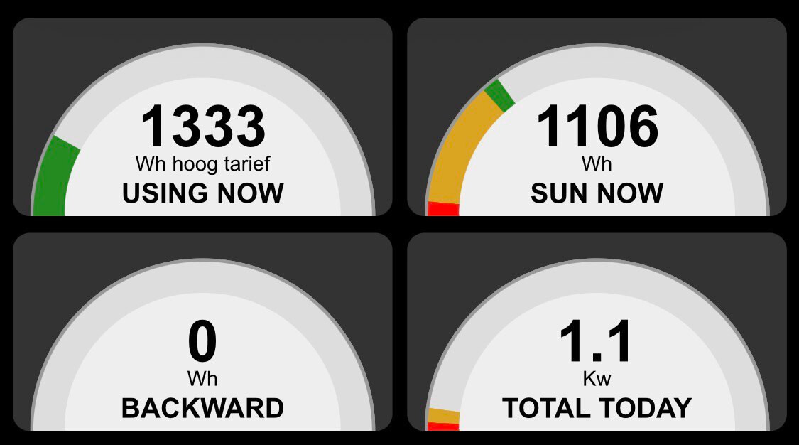

Use GitHub - sxdjt/canvas-gauge-card-continued: Community-maintained continuation of canvas-gauge-card for Home Assistant · GitHub .
With this, You can set i.e border " data-border-outer-width", and alot more, beside “touch-it” with i.e card-mod
But honestly, try to look at your Gauge-Card-Pro, in Your Browser-dev-Tools “inspect”, i wouldn’t be surpriced if you could use same/similar " data-border-outer-width" either direct in Card-Config, or through Card-mod
