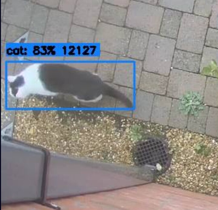

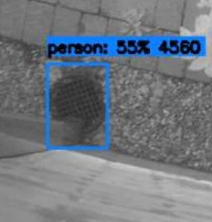

I have a classical NVR with cameras. Recording continuously.i have frigate setup to monitor some of the cameras and alert me when they detect motion just saving a snapshot to HA. Motion detection on NVR turned off or ot will alert me every few seconds.frigate runs on an intel nuc.
I hate that cat.
I hope the clown in the drain gets it.
