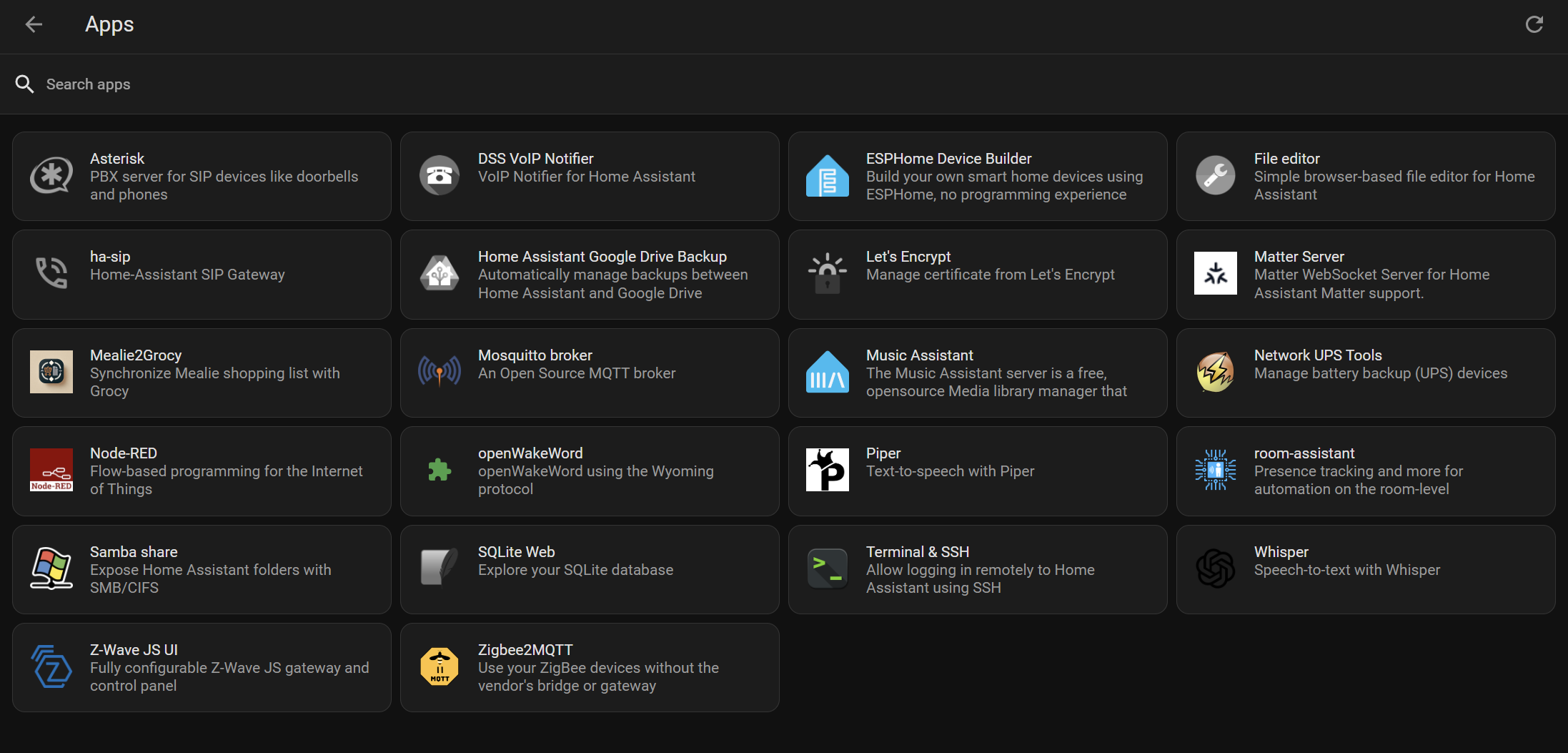

Apps = New vocabulary for ‘addons’ (because it wasnt complicated enough.)
You can load ‘Apps’ inside a HAOS install - basically specially baked Docker containers specifically for HA…
No they’re not available as standalone docker containers. If you want docker bare - use docker and your favorite container registrar…
