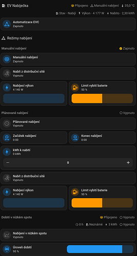

I’m not sure if this helps or if it’s the best or simplest approach, but I’ll share how I’ve handled a similar setup using a Solax EV charger.
To keep everything organized and maintainable, I use a folder structure for my configuration files:
configuration.yaml
homeassistant:
  packages: !include_dir_named includes
This allows breaking configurations into smaller, more readable parts:
In the main automation YAML, I created a state machine to control the EV charger. It evaluates various binary sensors to determine the current operation mode.

Each mode is driven by a binary sensor. Here’s an example for planned charging, which activates based on dashboard inputs and conditions.

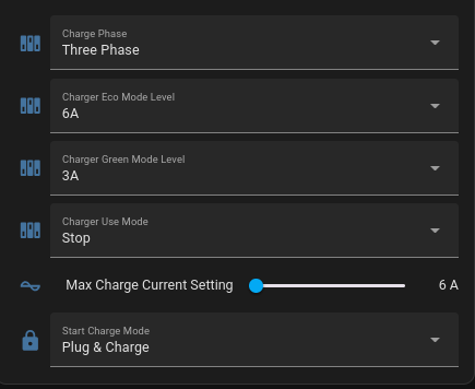

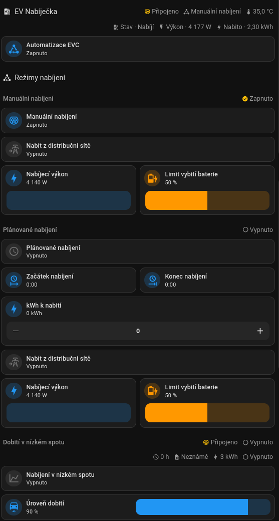

My control dashboard lets me toggle modes and conditions:
Through which I manage actually manage following entities, available from the integration:
