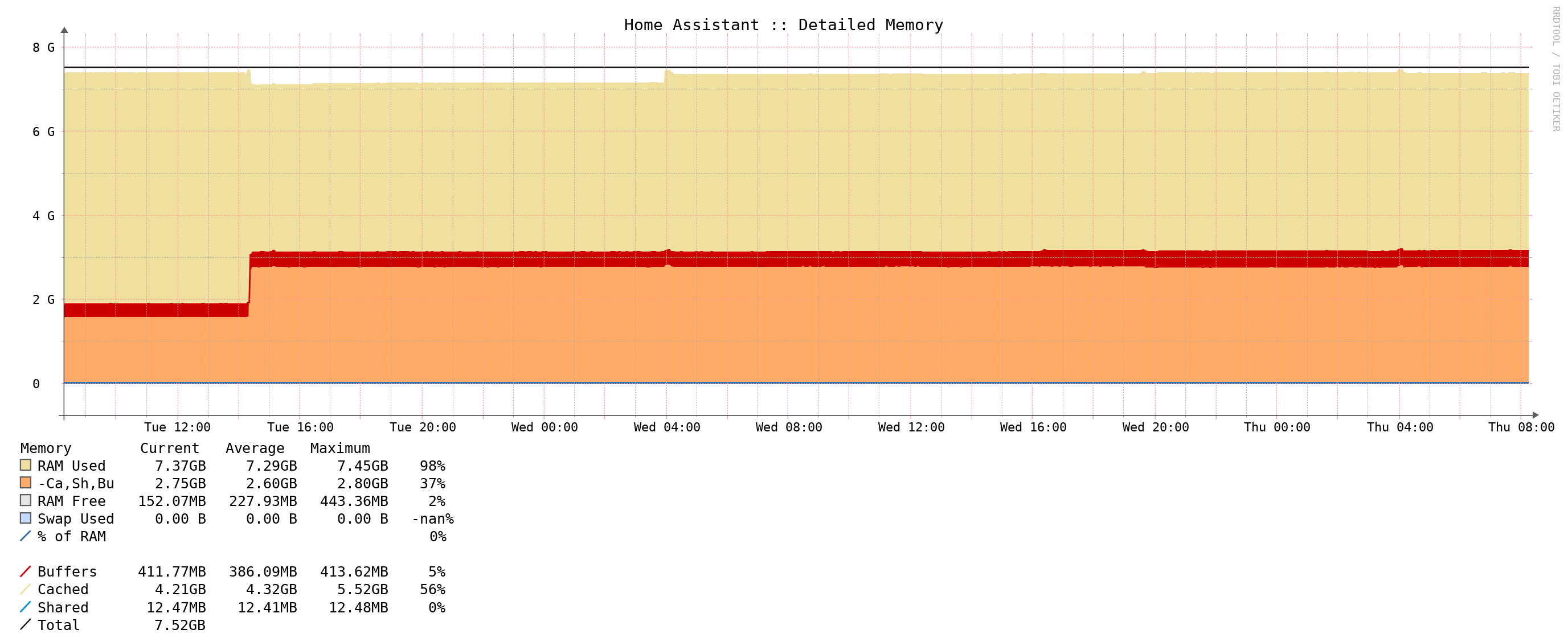

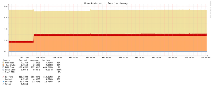

Just updated Whisper to 3.0.1 and its now using 21.7% of the system RAM out a a total system wide usage of 37.8%, seems somewhat excessive in that it’s using at least another 1Gb of memory compared to the previous version. (1.74Gb in total…).
Or is it just me ? (eg. vs. Piper’s usage which is 0.5%)

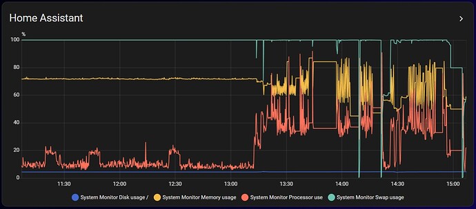

Similar issue here and also using around 20-30% cpu (on an rpi 4) - whereas it used to use almost none.
I think you can guess where the update was… (The drops are where the rpi rebooted.)

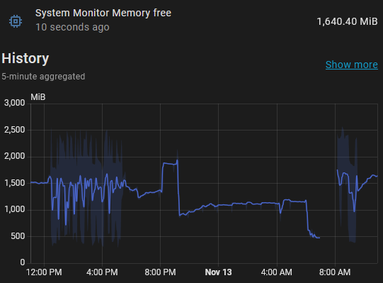

Seeing something similar here too. On my rpi 4, it was enough to put it in a reboot loop every few minutes until I could disable the add-on. You can see the two periods where it was active yesterday and this morning:
I don’t have a lot of memory pressure on my system, but it’s a big jump in usage all the same
