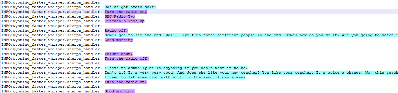

This is part of my Whisper log:
The stuff in purple is things that I have said to my HA VPE.
The stuff in blue, I haven’t said and I don’t even recognise as music/TV/radio that it might have picked up. WE speak British English here so nobody ever says “Mom”!!
How do I find the source with a view to stopping it?
TIA
It background gibberish from TV, noise or complete misunderstanding
These AI I tell ya!
Do you know how to cross compare this with “wake words”?
You can listen to the captured audio
Save audio to HA media folder so you may listen later
assist_pipeline:
   debug_recording_dir: /yourmediafolder
