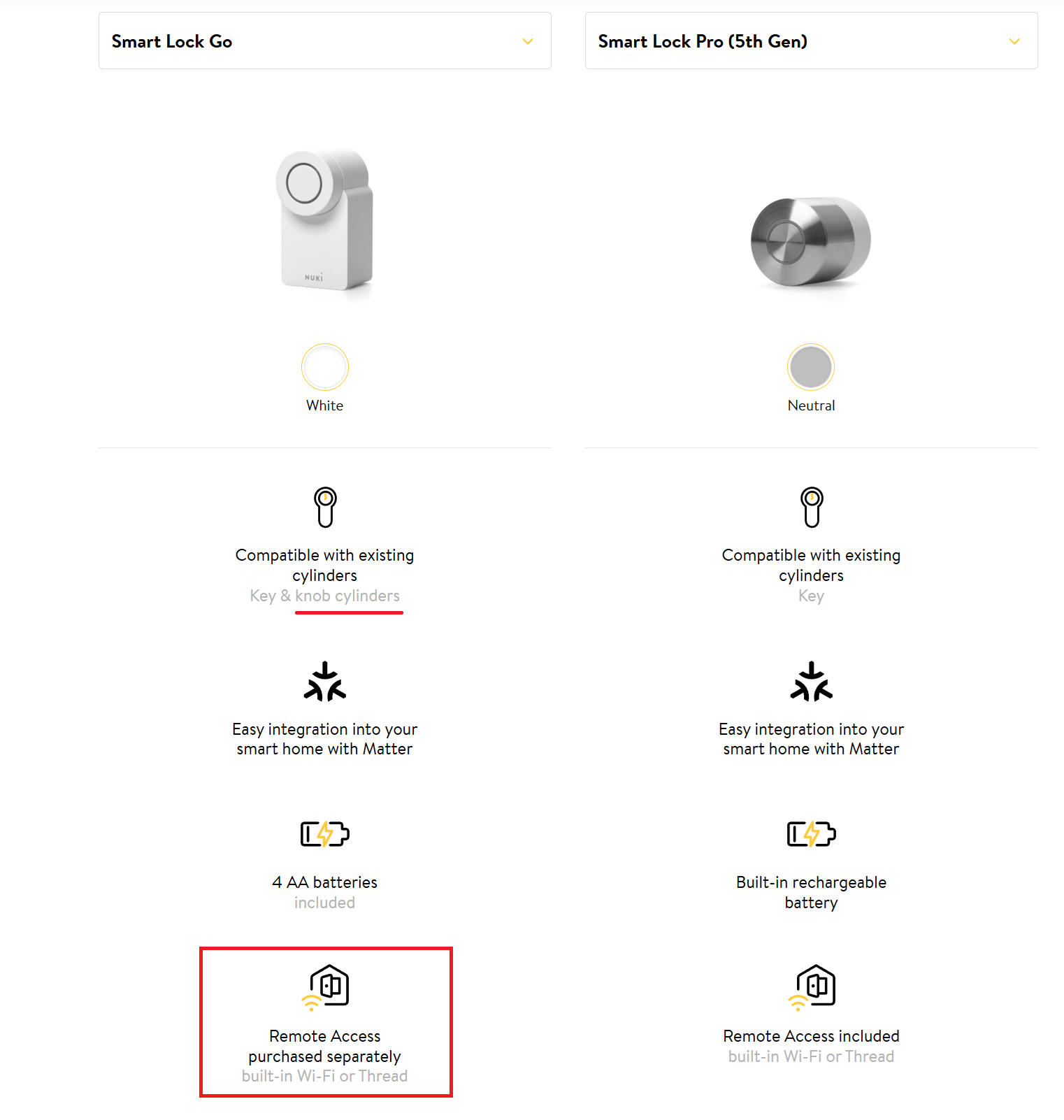

I’m thinking about buying a Nuki Smart Lock Go (the Pro version is not compatible with my lock). On the website, it says: “Remote Access purchased separately built-in Wi-Fi or Thread.”
This option costs one-third of the product price, just for an activation.
What exactly is this option ?
Without this option, can I still connect the Nuki Smart Lock Go to Home Assistant via Wi-Fi? Or is the Wi-Fi antenna disabled if I don’t pay ?

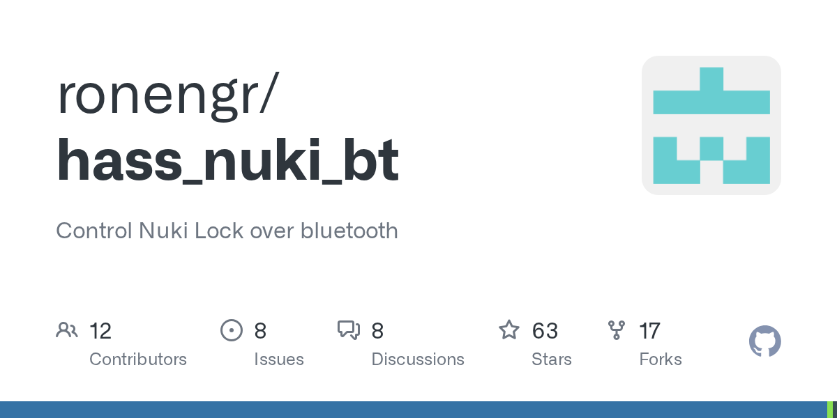

If it’s not possible to connect to Home Assistant via Wi-Fi without paying, is it possible via Bluetooth ? For example with ESPHome ?
Or with this project and ESP32 Bluetooth Proxy ?

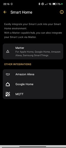

So I have the pro lock with wifi and in the app I have mqtt to setup. That just works fine with ha. No thread needed
Yes but the Pro isn’t compatible with my lock, only the “Go” version.
So if it has wifi, it might also just connect to mqtt. Then you’re done
That’s the problem. I don’t know if it has Wi-fi without paying. The device has Wi-fi built-in but it requires a payment for remote access.
I don’t know exactly what this payment is for. To enable the Wi-fi interface ? Or is it only for the remote access via the Nuki app ? Etc.

Digging a bit more, it indeed seems wifi is disabled. Payment to enable.
Matter however should be ok to do without payment, but then you require thread border router ( hub).
This should work fine (although personally I use the ESP32-based Nuki hub implementation) without additional costs. Integrates well with HA.

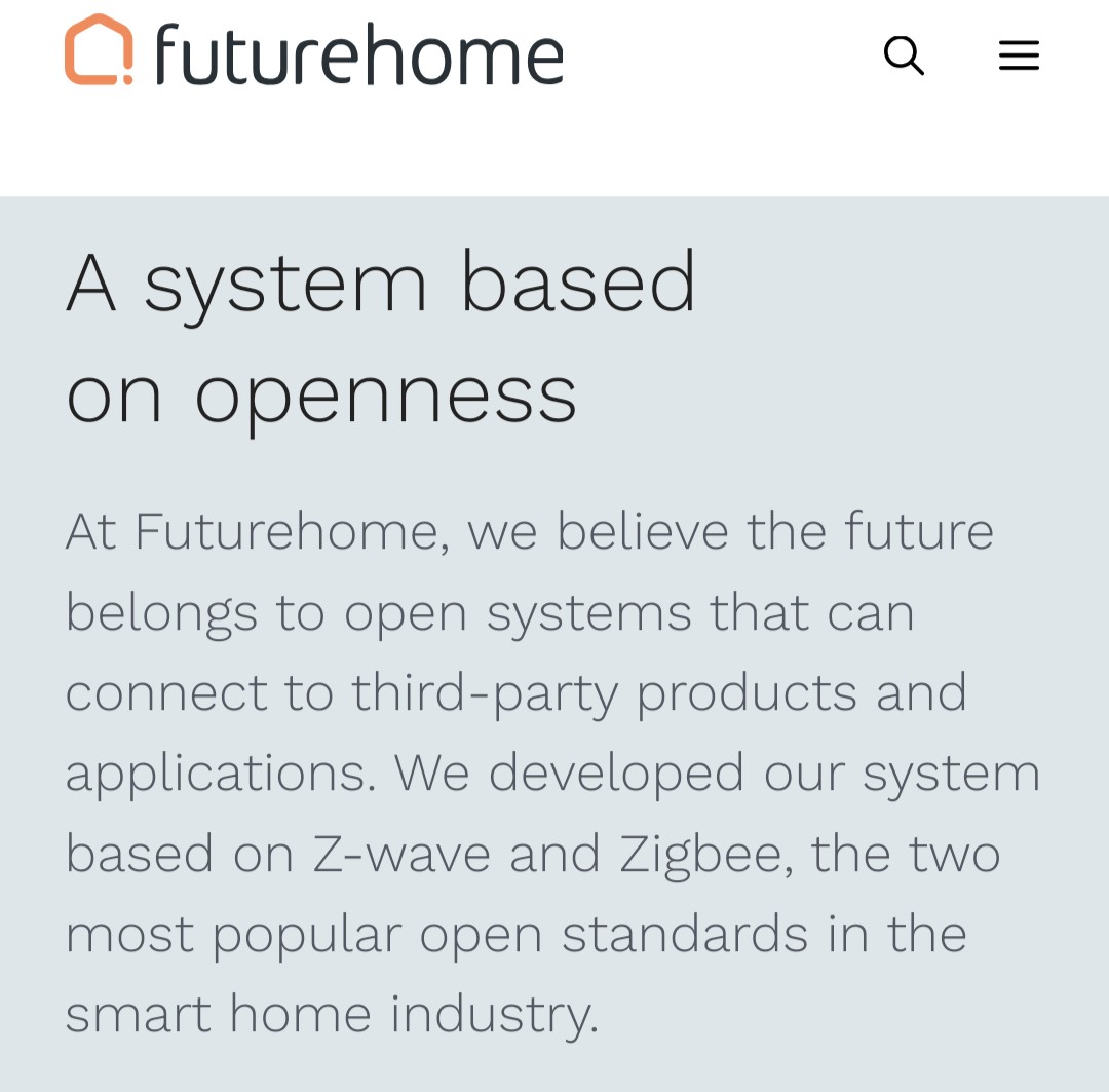

The new owners from futurehome (devices & company) even went that far to threaten potential buyers of their hardware who try the circumvent the bricking (restore local access) without paying with the police :bowing_man: :rotating_light: :oncoming_police_car:

Same thing is was true for the “always local” ZigBee/Z-Wave/Matter-ready Hub sold by futurehome… until they shipped the update deactivating all local function until the annual ransom fee was played to restore (formerly free and local) functions :gear:

Does it really make a difference? They removed all local functions via firmware update (probably had a similar TOS prepared as nuki) and have the insolence to even threaten their customers at the same time? :face_vomiting:

Further they ship MQTT functionality and are clearly open to you using whatever you want to use to talk to their devices. I see no issue at all.
Integrate Nuki into your Smart Home faster than ever before’:
And also check the list of compatible Matter hubs:
I personally have a Pro 4th Gen (which physically looks like a Smart Lock Go) and i use Wifi and MQTT to get information into HA. It is rock-solid.
The exact same marketing strategy was communicated by futurehome before they intentionally bricked their formerly fully local Z-Wavev/ZigBee/Matter-ready hub and started their extortion (and by accident increased the company value/revenue?) :thinking:
That means (unlike it is the case with @robertklep device which can’t talk to nukis server atm) the exact same thing like with futurehome could theoretically happen. Technically and legally everything seems in place at nuki to strip or limit local functions and introduce some subscription fees. :money_mouth_face:
It’s not that I think the present team in charge for nuki (that I have no idea who they are) plans to do some rugpull but realisticly cooperate greed always wins - and with futurehome it also was a change of management (or ownership?) which started the enshittification train :steam_locomotive:

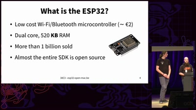

You know that parts of ESP device firmware are closed source blobs, right? Who knows what kind of kill-switch Espressif has built into those :man_shrugging:t3:
Same is true for phones, computers, cars, smart locks, {your favorite tech here}, … :person_shrugging:
And it probably isn’t going to change too soon even though some people make good progress :point_down:
Reverse Engineering the ESP32-C3 Wi-Fi Drivers for Static Worst-Case Analysis of Intermittently-Powered Systems
