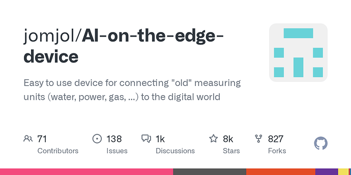

I installed Ai-on-the-edge on my legacy water meter.
Cost are around 15.-
It is accurate to around 0.05 liter (basically less than half a glas of wine).
To detect a leak, I use an automation that will alert me if the flow of water doesn’t go to Zero for a set time (currently I use 30 min).
Data are sent to HA via MQQT.

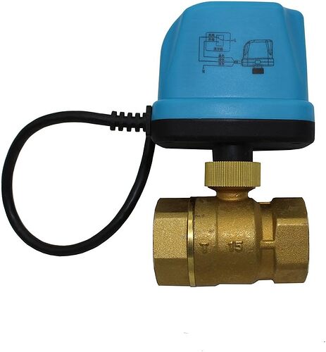

All you need now is a motorized valve (30,-) that will close the mains through a shelly 1 (or similar), if HA thinks there is leak .
Additionally I still use my old Shelly floods in critical areas (behind dishwasher and washing machine) - in case they report a flood it also closes the main valve.

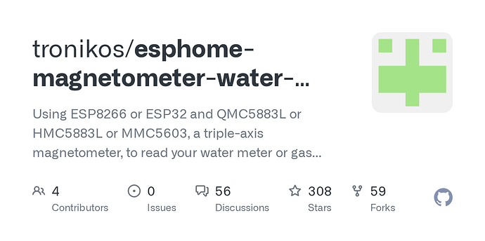

For my gas meter and irrigation (separate meter) they both have spinning magnets so I use this on those:

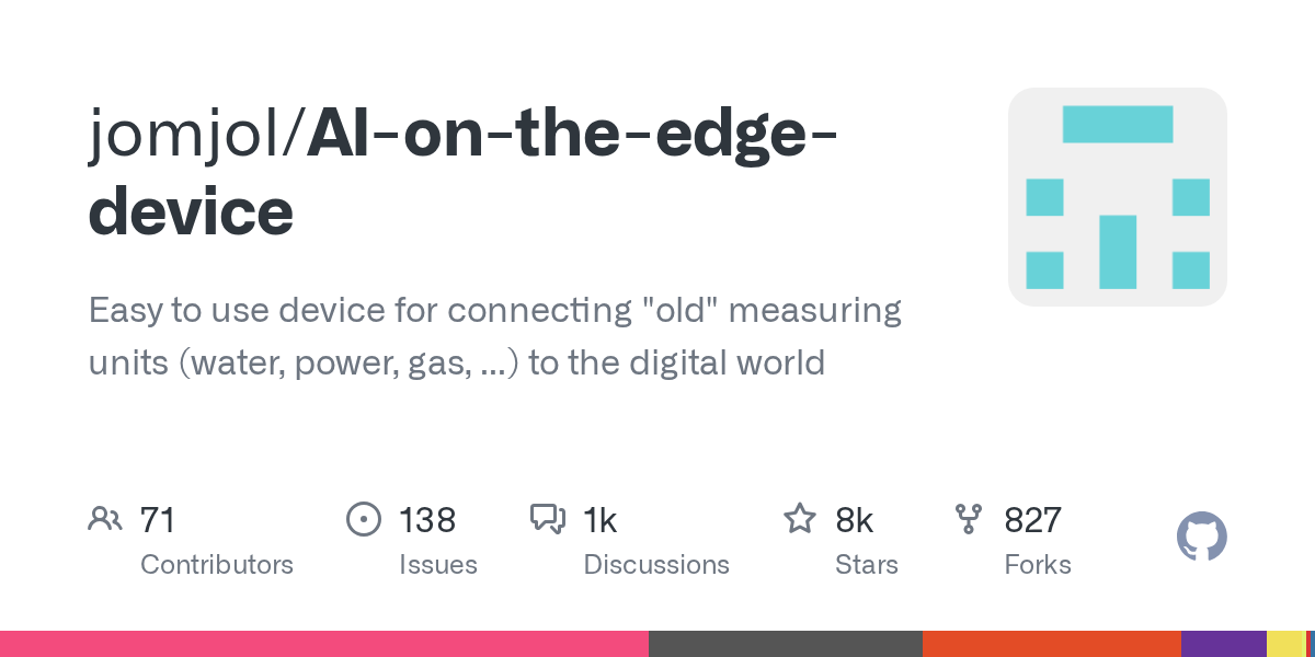

I did try the Ai-on-the-edge on my irrigation meter. I just couldn’t get very consistent readings. Plus, that meter is read manually so I couldn’t cover it.
