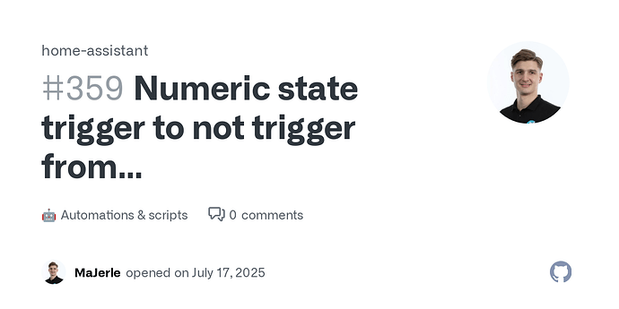

At this point I am wondering why numeric_state trigger doesn’t have the not_from optional parameter to specify that if transition is from non-number state, it doesn’t evaluate it.

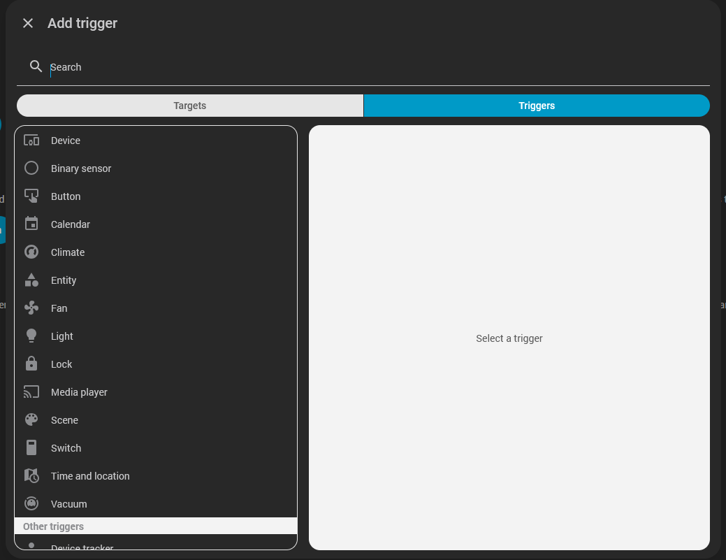

Except when it’s not in English and it’s still sorted like that. I still think it was done on purpose, because the devs consider devices to be easier to understand by new users than entities (and they are right in general). Either way, this is going to be replaced by the new purpose-driven triggers, where the UI is really confusing (at least to me), but it prioritizes areas, not devices.
it prioritizes the group based options, not necessarily just areas. It can also target entities or devices too. I don’t believe it’s fully complete for devices just yet. But entities, helpers, areas, labels, floors are partially complete.

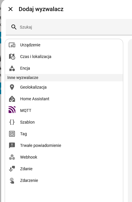

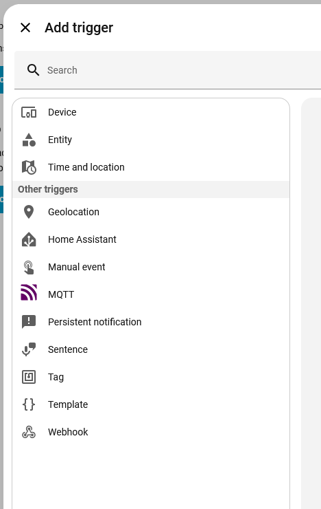

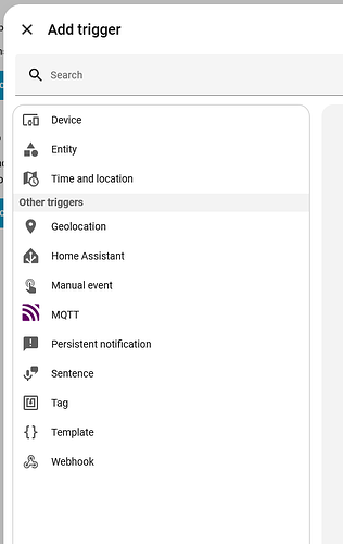

I checked now how it (=the current/old design) looks in English, and I’m astonished, that even though it’s sorted alphabetically in English, in Polish it’s neither sorted alphabetically, nor the same way as in English, but even differently… The time and location is between device and entity in Polish version. This feels to me like the device was put on top, and the other two are sorted alphabetically. I think this was done deliberately, not an effect of alphabet sorting.
Alright, I believe you. I honestly tried using that UI for a bit, but it was still missing a lot of triggers, and I was quite confused by it.

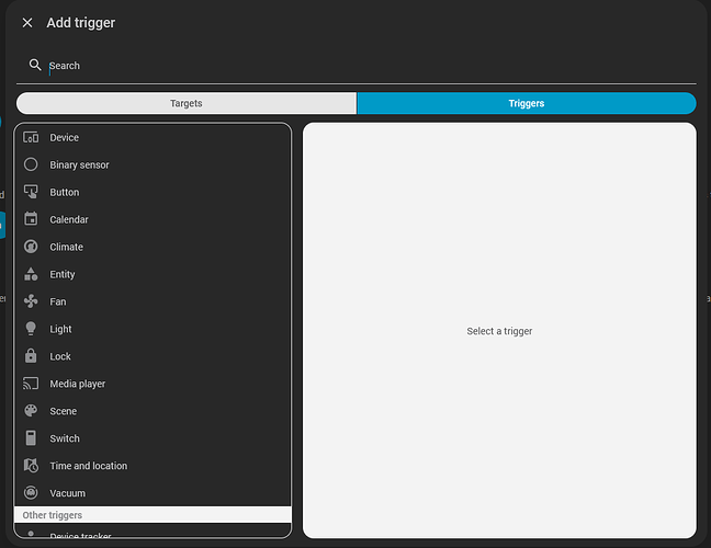

You’re using the old menu. The labs menu is what will be the default in the future. It’s sorted alphabetically aside from device.
EDIT: Ignore the colors, I haven’t updated my theme in ages.
I know. Sorry, I was not very clear. I was talking about 2 different things, one was the current/old menu (the sorting there is not alphabetic), and the other thing was the new menu, which I find confusing.
