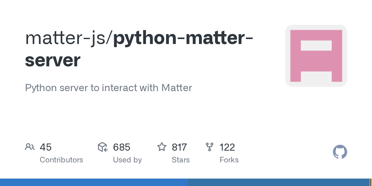

You may know this already, the Python Matter Server is in the process of being replaced by Matter.JS based matter server. Devs will still entertain bug reporting, but may not get acted on quickly if at all dependent on severity.
Important
We’re excited to share that the Matter Server is being rewritten on top of matter.js! :tada: This means that the current project has moved into maintenance mode — we’ll still fix important bugs if they come up, but all new features will land in the new project instead. We’ll post a link as soon as the first alpha version is ready for you to try out. :rocket:
