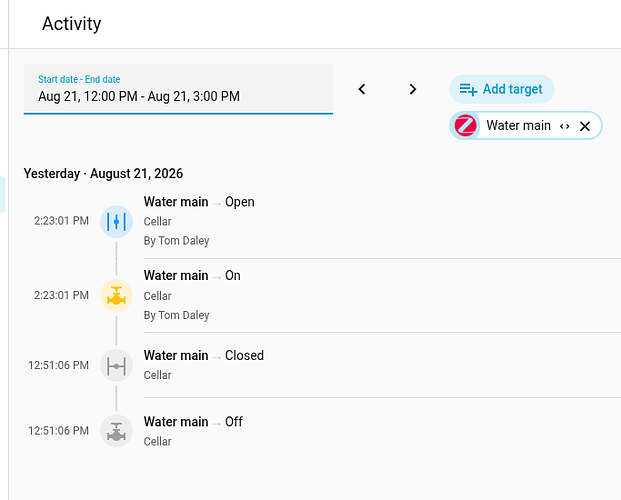

Yesterday HA turned off my water and I don’t know why. I do have moisture sensors and an automation that turns off the water main if there is a leak detected, but that did not happen. The logs don’t show any sensor detecting water. The automation should also send an email and a notification if triggered and that did not happen. The log shows the water main being turned off but not what instigated the action.
If there is no context in the activity log (e.g. “by automation xxx” or a username) then it happened outside home assistant.

It’s not the automation. We have already established that from the lack of context in the activity log.
