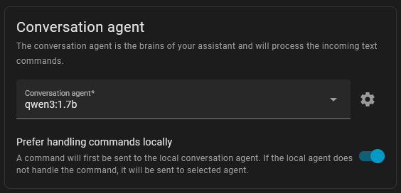

Hey, sorry, yes i am using qwen3:1.7b,
and my assist is able to control other devices.
Why it failed to do local processing is another interesting question…
Ok, i will try that, thank you.
I would suggest that the model is not large enough for home management tasks.
This sometimes happens if the conversation already has a message history. On satellites, it is reset after a few minutes of inactivity. It is best to run tests in the dashboard, as each time you open an Assist chat, a new conversation is created.
