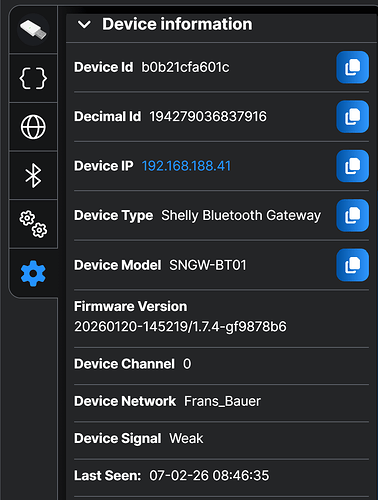

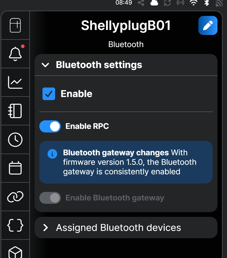

Hi, I have multiple Shelly devices (e.g. ShellyPlug-Gen 3 the ShellyBLUgateway or ShellyPlus1PM) all offering BLE gateway capabilities.
In the Shelly devices BT gateway function and WIFI are enabled.
Access point, range extender, websocket, RPC and MQTT disabled.

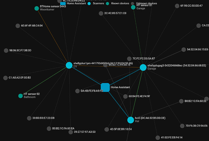

When I go in HA to my Bluetooth adapter overview, I only see 3 adapters, on 2 are Shelly. Why do I not all see all Selly devices as gateway?
And how can I fix this?
Note that several Shelly devices report a poor Wifi signal while I have 5 Unifi Access points installed around the house so I would expect the WIFI coverage is fairly good. This I find also strange.
Thanks for tips!

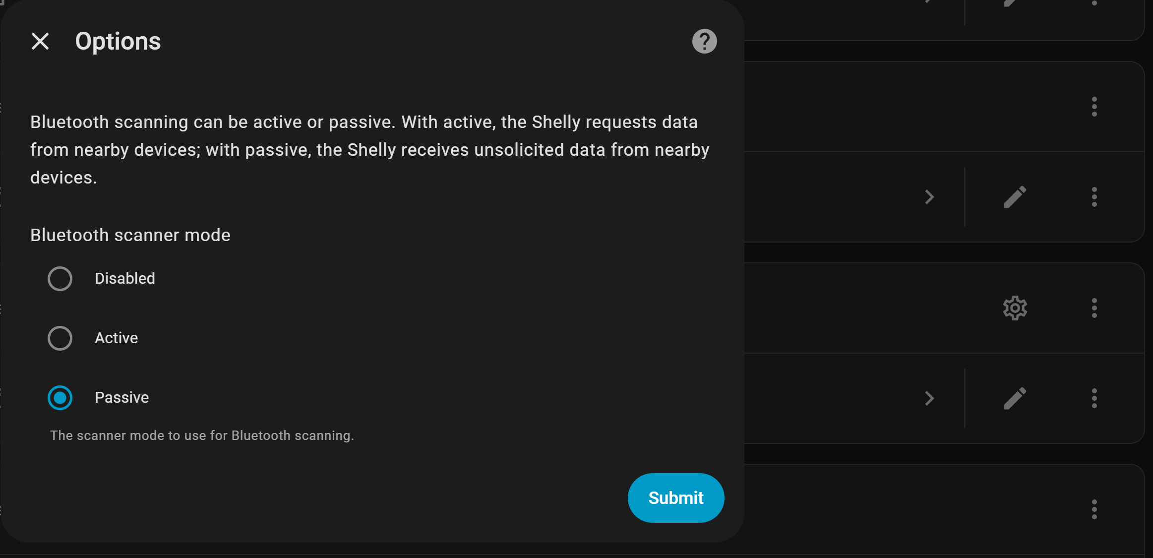

Have you also enabled it on the HA side for each (the settings cog for the device in the Shelly integration)? I believe it defaults to disabled.
Correct you need to enable passive scanning in the Shelly Integration.
Click on the wheel, and a pop-up opens to select it. Thanks!!
