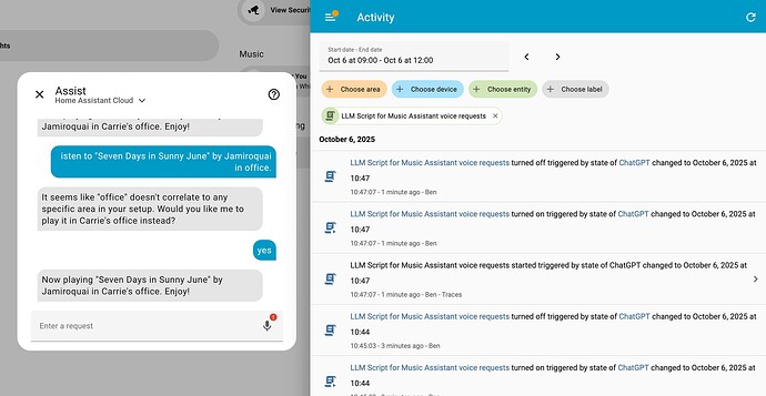

Why does Assistant say it's playing music when it doesn't?
I’m trying to control the only integration with Music Assistant that I have, which is Spotify & Sonos. Using Assistant, whether it’s voice or written like it is here. The other day it worked, now it doesn’t work, and it’s not giving me any error or I don’t know where to find what that error is. Here’s a screenshot of activity and my conversation with Assist.

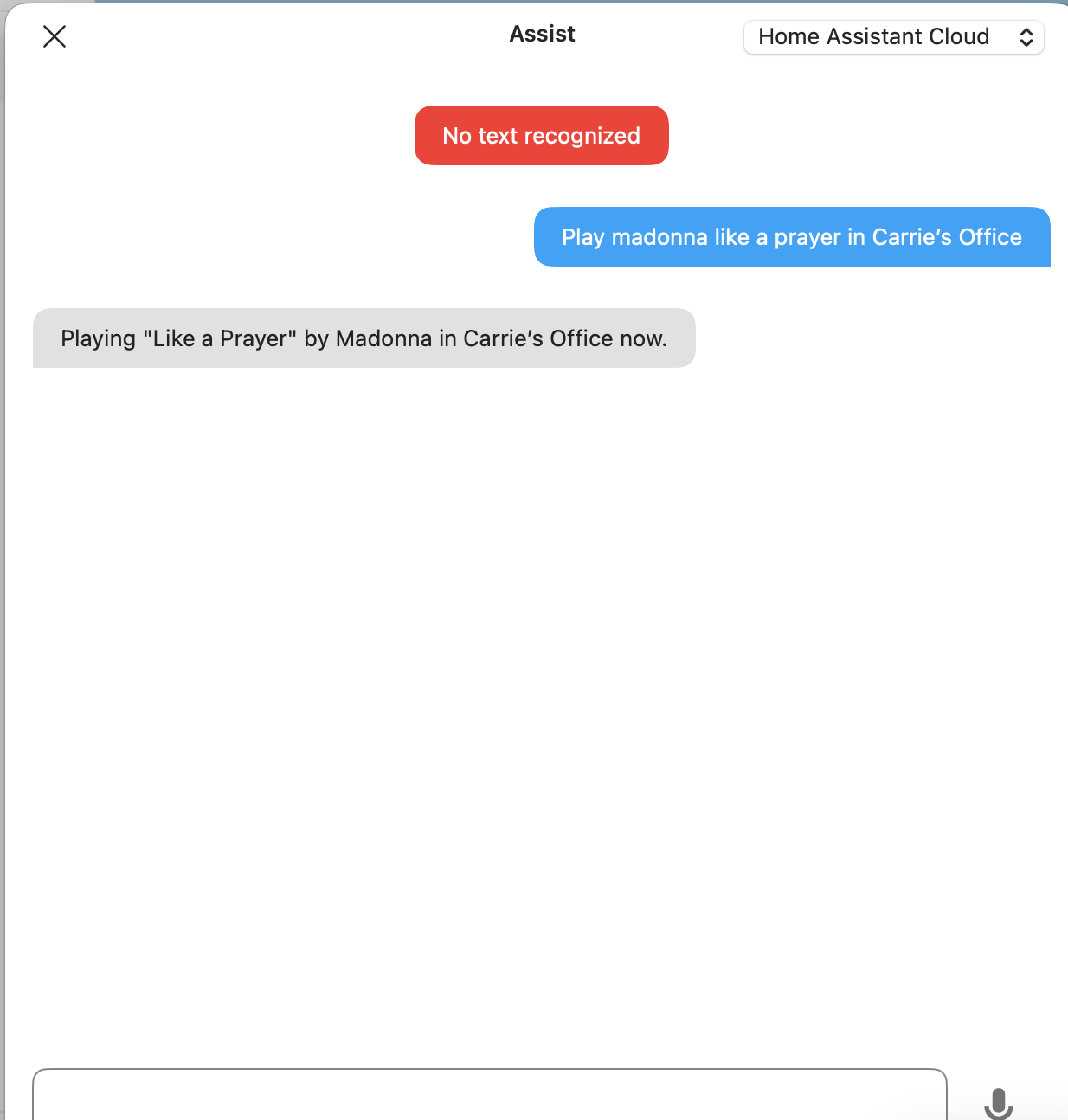

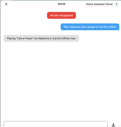

When I say “pause [or play] the music in Carrie’s Office”, it works, when I say “Play madonna like.a prayer in Carrie’s Offlce” it says:
It does not play.

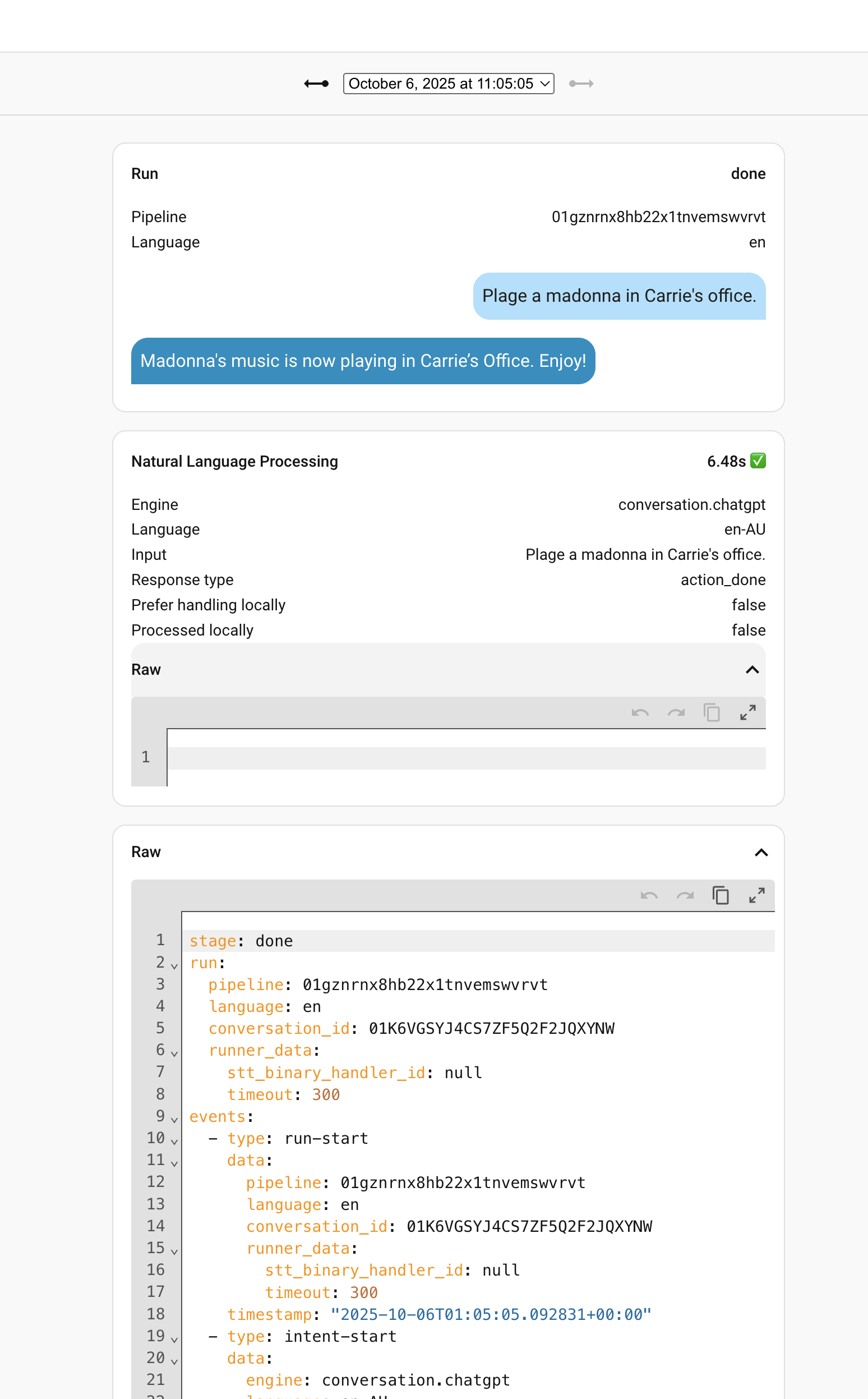

go to settings - voice assistants - [ your assistant ] - three dot menu to the right, select debug - find the ‘failed’ conversation.

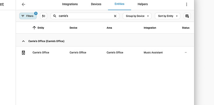

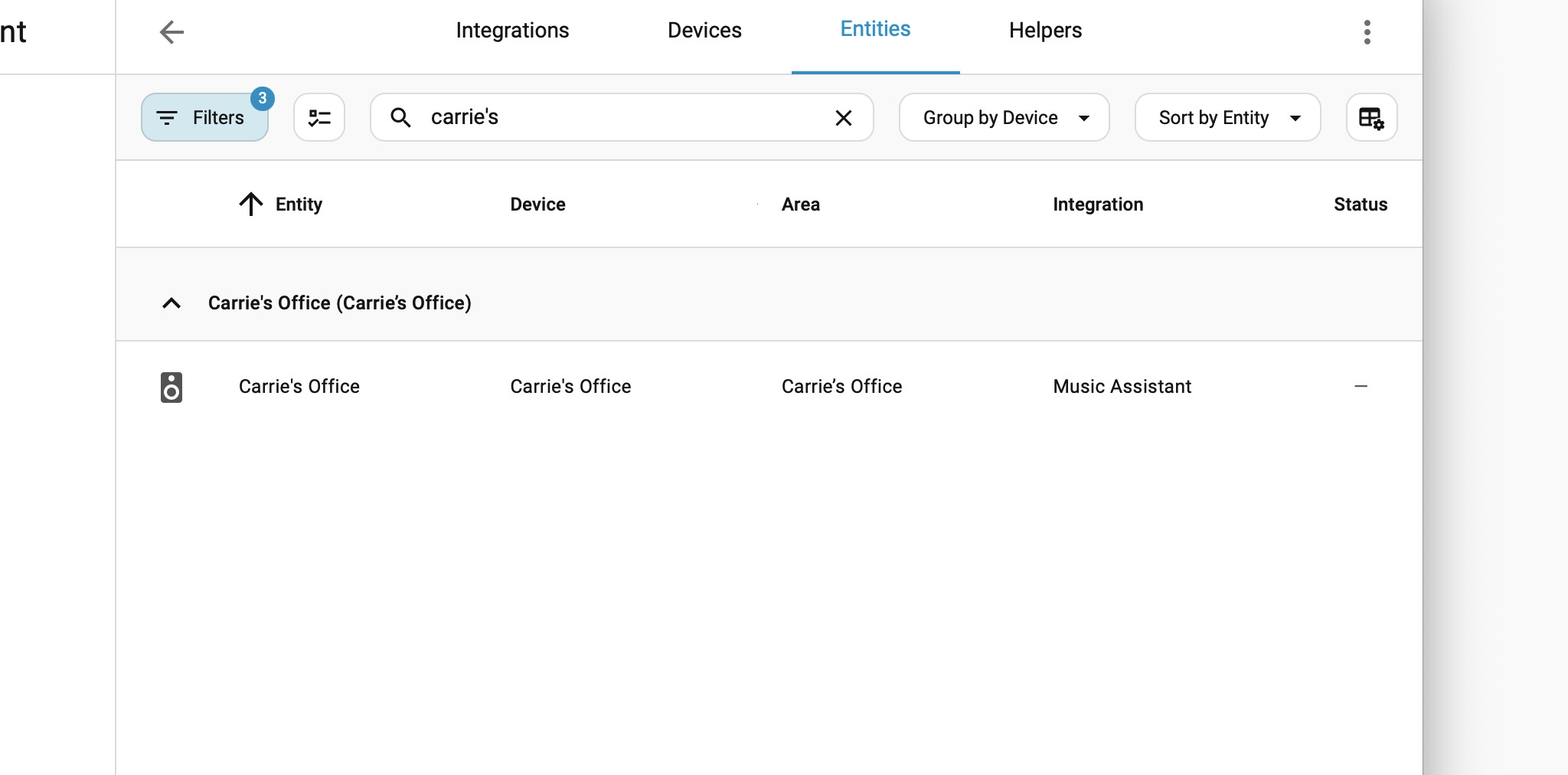

I found the music assistant media player and set it to be in the relevant room. Still no joy.
Is there a better script I should be using?
