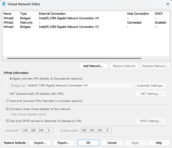

Windows 11 Host with a 4 port NIC

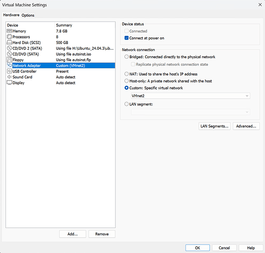

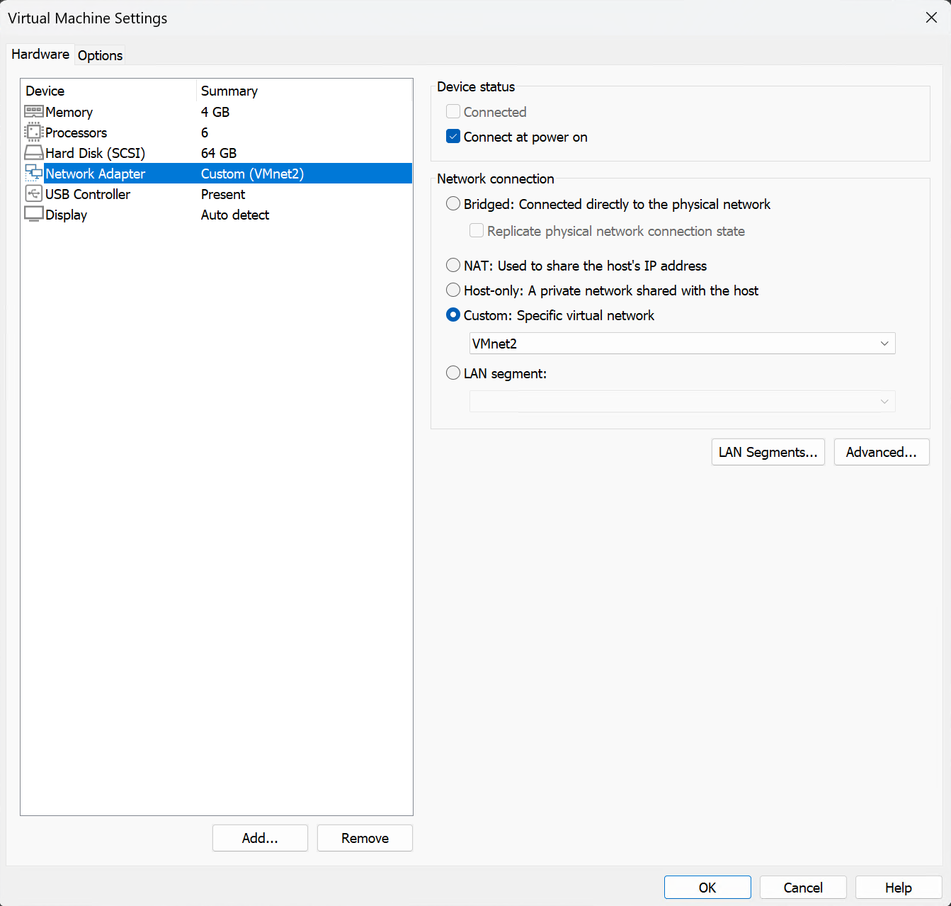

VMWare Running 2 Clients. (HAOS and Ubuntu - Nextcloud AIO)
VMnet0 = Is one NIC used for HA
VMnet2 = Is one NIC used for NC AIO
The only way this works if both HA and NC AIO are on the same NIC or VMnet.

4 Port Intel i350 NIC
Windows 11 Pro
Router Ubiquity DR7 - 192.168.1.1
I’m on Windows 11 so I can’t do anything ‘fancy’ with settings inside windows (outside of segmentation), so I have to rely on my router.
Port 1 (Manual Set) - This is the Port I want Nextcloud AIO on.
VMware - VMnet2
UDR7 - 192.168.80.0/24
VLAN80 (UDR7) 192.168.80.153 OR 192.168.1.153
Windows (See Below)

So it doesn’t make a difference if I have each (HA & NC) VM NIC Ports on the same VLAN (Default (1)) or on their own respective VLAN (1 & 80). If they are on separate NIC ports (either directly or via VMnet(x) ) Home Assistant Dav or Uptime Kumu will not communicate with Nextcloud.
This confuses me as both are communicating via WAN on 443. Furthermore all other dav / Uptime Robot programs have no problem communicating with Nextcloud. I only see the problem with Home Assistant.
Hopefully you can see the problem?
