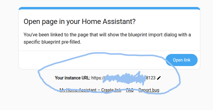

If you cant load blueprints it will be due to the link circled in this pic not pointing at your ha server. Edit so its correct.

It opens up HA when I click the link so I don’t think the problem was with not finding my instance.

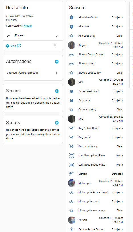

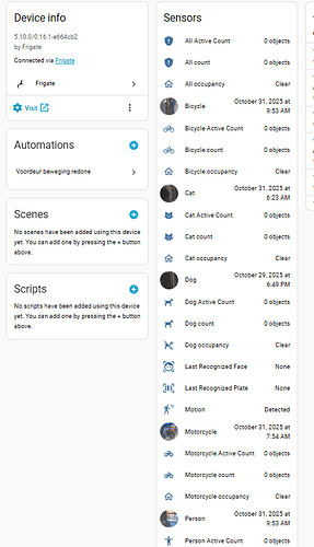

what entities you have now on a frigate device in HA?
this is an camera entity:
That one can snapshot too. But like Arh says, you can do so much with frigate, thats also something to explore.

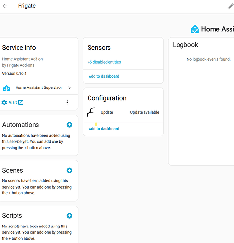

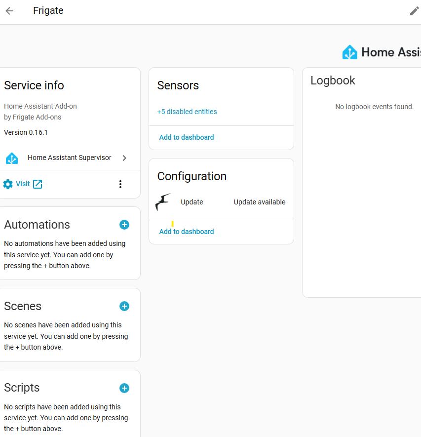

I think I must have Frigate installed in a weird way. When I go to the “System>Devices” tab I see two entries for Frigate. Neither have anything like the info you show. Here is the first entry:
Curtis
@checking12,
I figured out my Frigate problem and why I did not see any Frigate entities. I had downloaded the “HACS Frigate Integration” but did not finish or properly configure it. I now see a bunch of stuff similar to what you posted.
