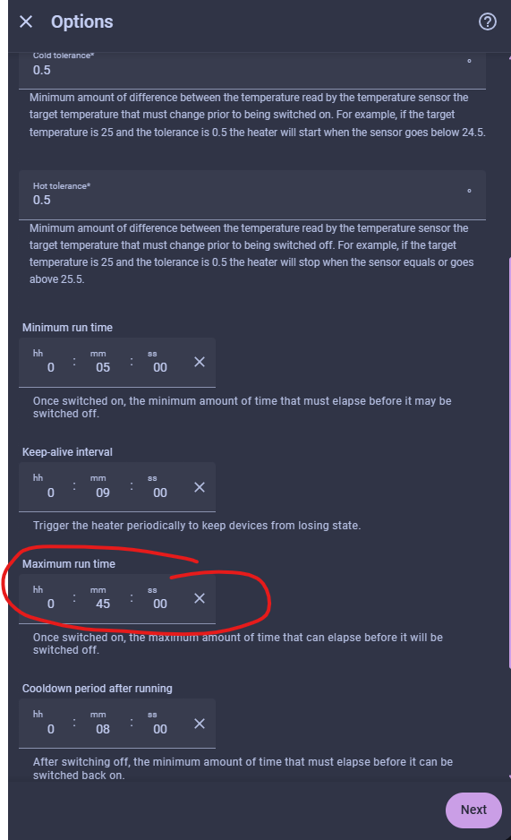

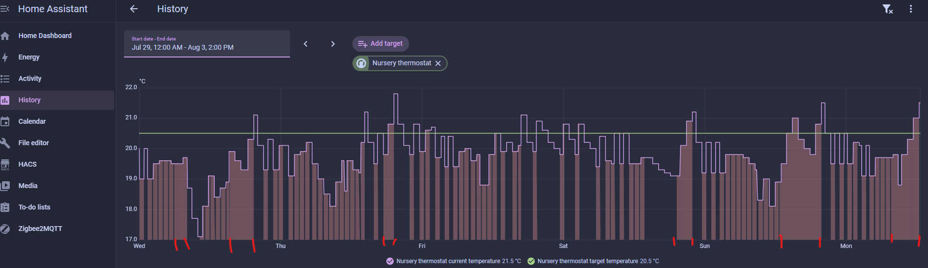

Hi, my generic thermostat setup, which uses a sonoff temperature sensor to switch an oil heater on and off via a zigbee power plug, seems to ignore it’s maximum runtime about once a day and I can’t work out why. Any ideas?
