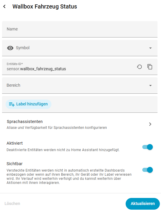

works fine so far, can be displayed in the UI no problem.
strage is in the entiy search i find the following
so first question is … why does it get another entiy_id even i defined a unique id?

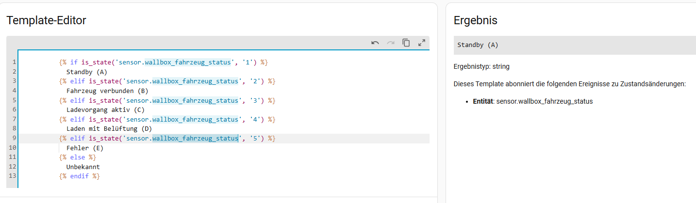

i tried to use sensor.wallbox_fahrzeug_status as well as sensor.wallbox_juice_vehicle_state, but i never get a entity Wallbox Fahrzeug Status Text … but also no error … any idea what i am doin wrong?
PS.:
here at least the code seams to work fine

The entity ID is not determined from the unique_id.

It creates a new entity, it doesn’t overwrite your existing one.
Look for sensor.wallbox_fahrzeug_status_text
