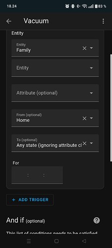

I’ve made a family group.
And in the logs i can see it functions correctly and gets set to away from home.
But my automation doesnt seem to trigger…
Any help would be much appreciated.
I would like it trigger when we’ve both left home, dont care where we are…
Code:
alias: Vacuum
description: “”
triggers:
trigger: state
entity_id:
group.family
to: null
from: Home
conditions:
actions:
device_id: b94722d480f3c77d2286b5b07373815e
domain: vacuum
entity_id: a9ea1f795cc9b867b4c6102871a4e13e
type: clean
mode: single

old school groups (group.xxx
entities) use old school states.
home
, not_home
and the Zone name. You’ve used Home
and that is likely your problem.

Then you’ll have to stick with old school groups and deal with their state accordingly. I.e. use home
not, Home
