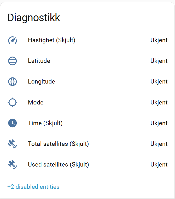

In my boat I have gpsd running on one Pi (192.168.3.2) and Hass running on the other (192.168.3.1). Hass gpsd integration keeps loosing the connection to the other Pi. I have gpsd running directly (not in a container) on 3.2 and Hass running in Docker on 3.1. It shouldn’t be the network because I have network_mode: host on the container. Today I was out for three hours trolling mackerel, but the integration hasn’t logged a meter of that! The last time it logged was a week ago. This is the screen on the integration:
“Ukjent” is Norwegian for “unknown”. The problem is not the gpsd daemon on 3.2, because this is a screenshot of cgps on 3.1, so same Pi as Hass is running on (I removed the lat and long, so I don’t tell the world where my boat with two Pi’s is docked :joy: ):slight_smile:

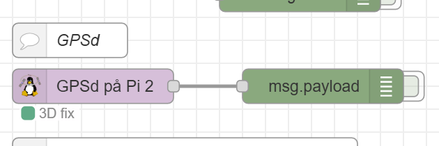

And this is Node-RED running in a container on the same Pi as Hass, 3.2:
So that sees it too. If I restart the daemon on Pi 3.2 and then Hass it starts to work. But if gpsd has been running for a while when I restart Hass, it doesn’t help. And when I restart Pi 3.1 with Hass, the gpsd integration won’t work until I do another restart of Hass when the Pi is up. Here’s the full Docker Compose file:
