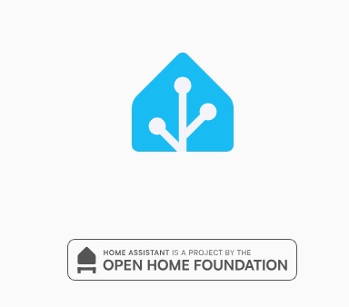

getting back to my original issue. As I suspected leaving HA running for a 6 days now with the IP Address Reserved in My Router, I am getting the page shown in the picture here. This will stay there indefinitely with browser refreshes. I also tried on Edge and Chrome and cleared Browser Cache. When logging into my router, I see it is still using the same IP Address that I set as reserved.
I see this using
Home Assistant - homeassistant.local
and
Home Assistant - 192.168.50.61
The Home Assistant App on Android quickly flashes the same start-up screen and then just reverts to a White screen.
