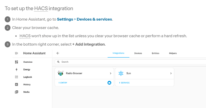

Sounds like it installed fine. Did you reboot Home Assistant and follow the next steps (Add the Integration)?
Thanks for the reply :smiley:
Sure did. It’s just there’s no visible evidence of anything in the side bar. No instructions of what to do next or how to actually navigate to the actual HACS page / install.
These are literally the next steps.
Ah! Perhaps it was the double reboot or trying to find HACS in the integrations for the second time but now it’s showing!
Thank you @mterry63 for your time :smiley:
