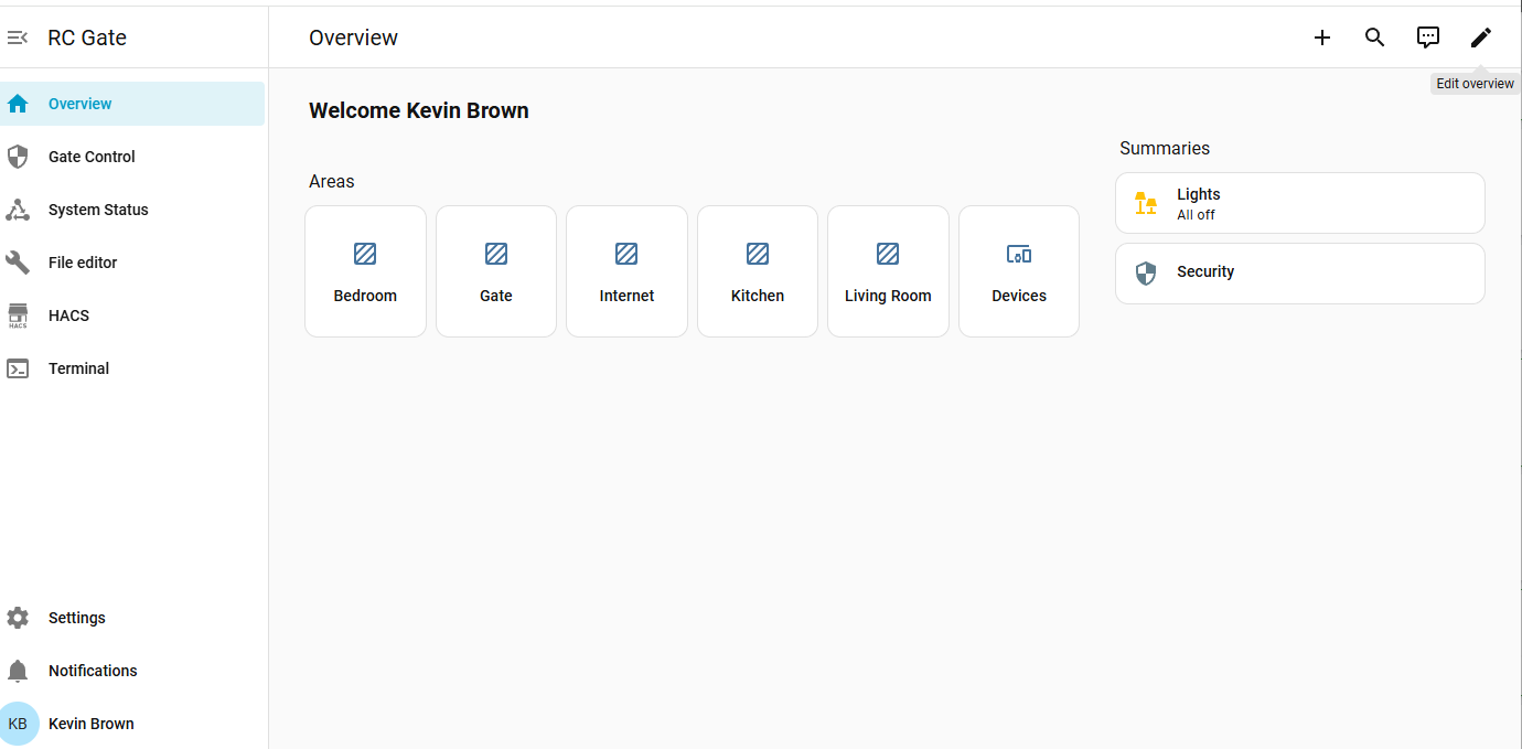

Show me how to make this:
Why you ask? I want consistency in views and this reacts perfectly to all screen sizes. I want most all my lights, switches, etc. built in a similar way but the only way it can be done is by creating hugely repetitive code. Any attempt to use auto-entities or decluttering templates fails. It will not scale anywhere near the view of the “default dashboard”.
After 1000+ experiments, I can only conclude that HA “GUI” people designed this “dashboard” by hand. They in no way use common cards that would allow their users to do something similar.

I believe it’s strategy-based so there isn’t necessarily a static YAML config in the way there is for user-constructed dashboards and views.
frontend/src/panels/lovelace/strategies/home/home-overview-view-strategy.ts at df61953ed41f4c40f1b73a01c874d578a13b72a7 · home-assistant/frontend · GitHub
So the answer really is it is impossible to generate that layout with built-in common cards like grid, tile minimally and most definitely not using auto-entities or decluttering.
That is a fine answer … because it’s an answer.
At least it saves me 1000 more tries.
And I need to abandon the entire thought.
IMHO, I find that wrong. Default things done by Home Assistant should use standard cards and be able to be replicated. Otherwise that “default dashboard” by Home Assistant is absolutely worthless.
I think it is using standard cards, mostly Tile, Grid, and Area by the looks of it. And, anyone could make their own strategy… it’s just more complicated than a regular dashboard. A few people have even shared them here on the forums over the years:
