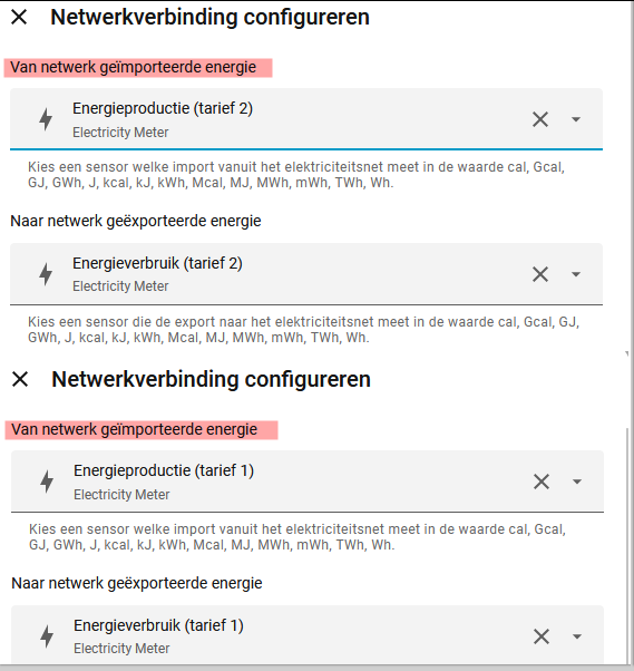

I have the following configuration:
Must the second tarief under the first?

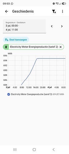

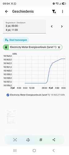

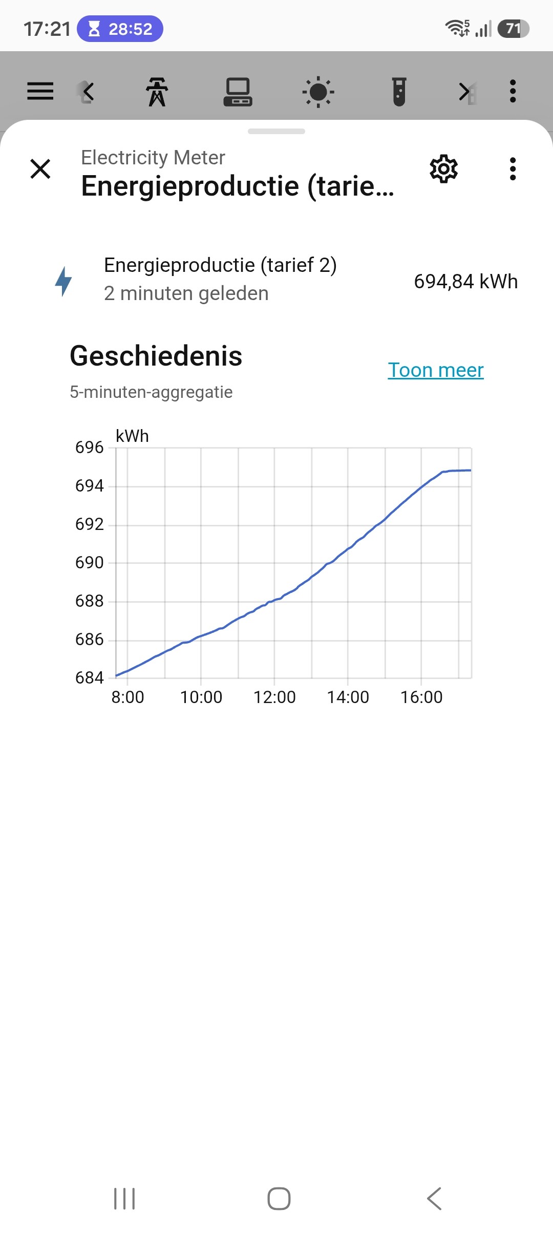

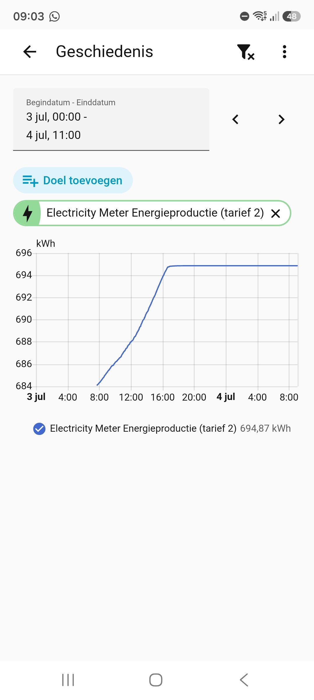

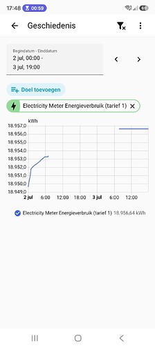

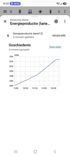

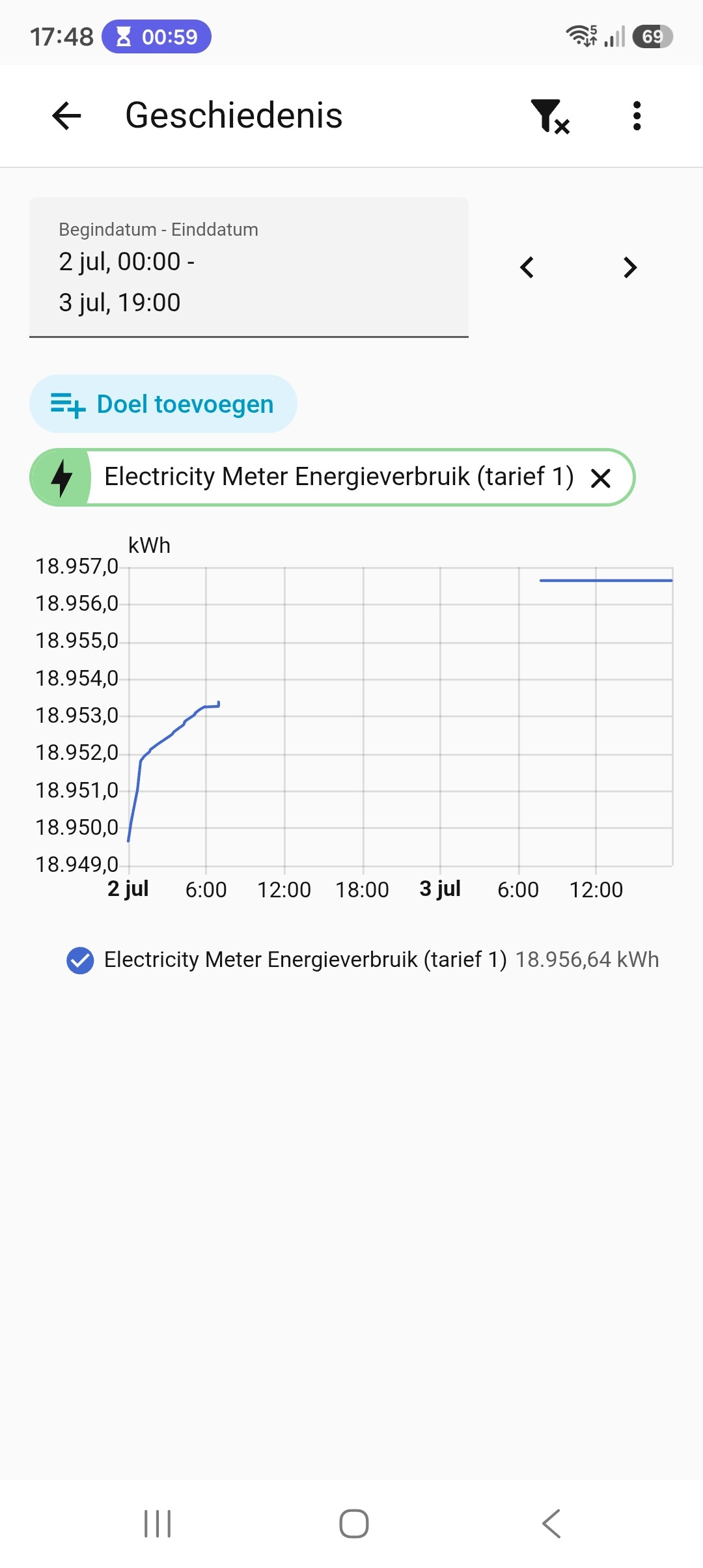

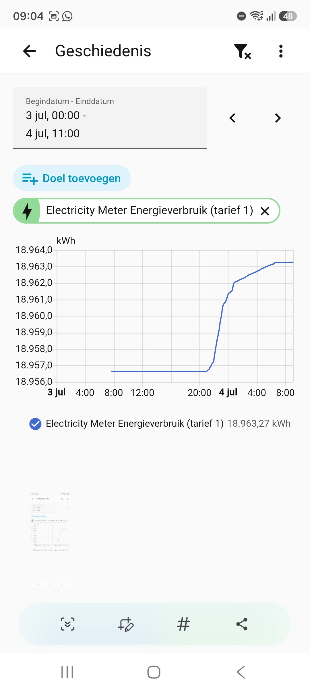

What do the history graphs look like for those sensors?
The look normaal and positive values
That’s one during the day time - what do both look like over 24 hours?
Both are. Positve values
Possibly one of the other energy sensors is going negative (discharging to grid) at night - check them all over 24hours
That is not the case

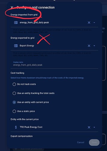

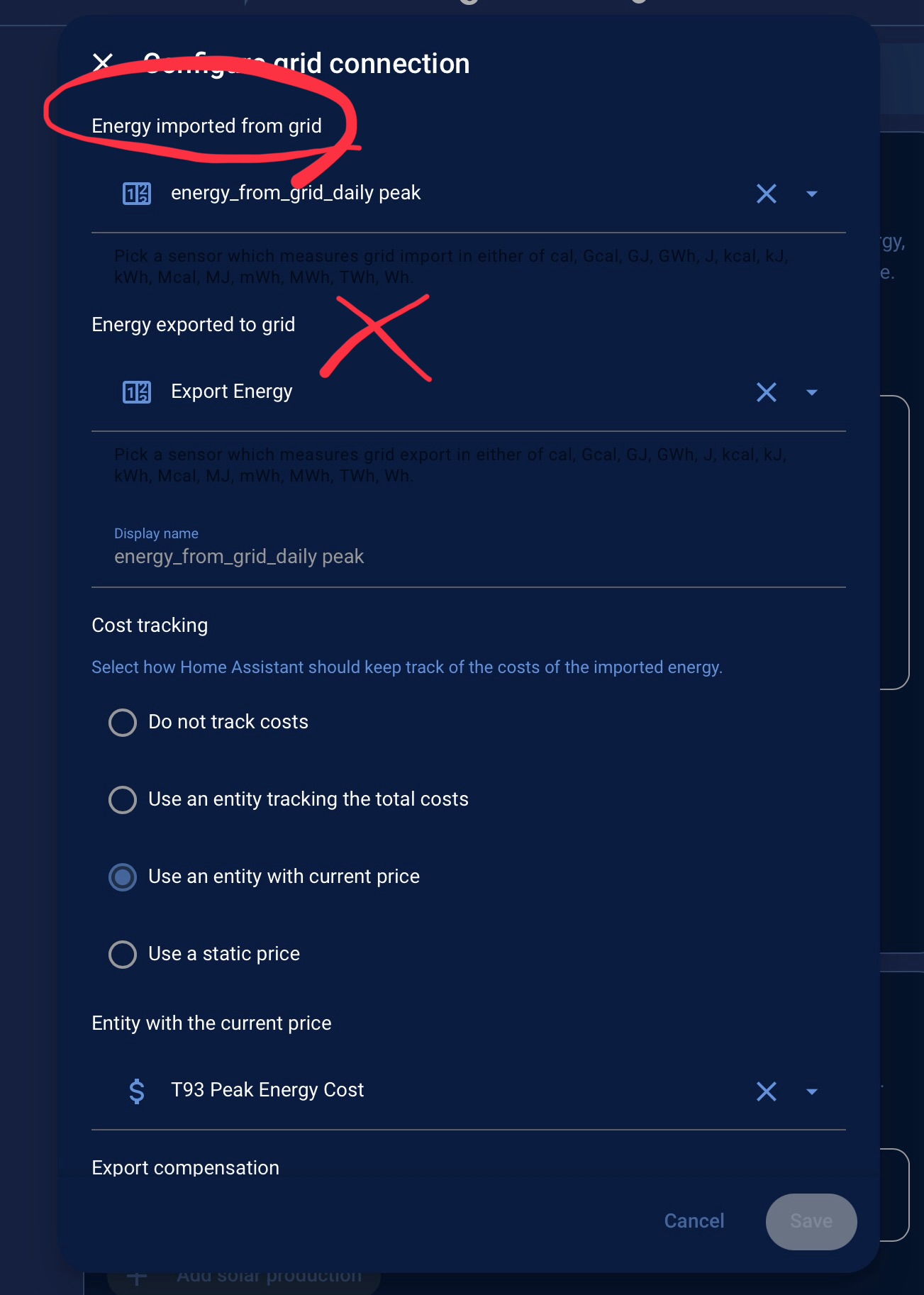

Both of these:
        "type": "grid",
        "stat_energy_from": "sensor.electricity_meter_energieproductie_tarief_1",
        "stat_energy_to": "sensor.electricity_meter_energieverbruik_tarief_1",
Should be in the from_grid section.
The to_grid section is only for an export sensor.

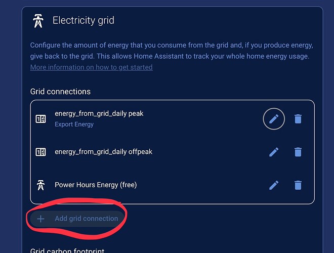

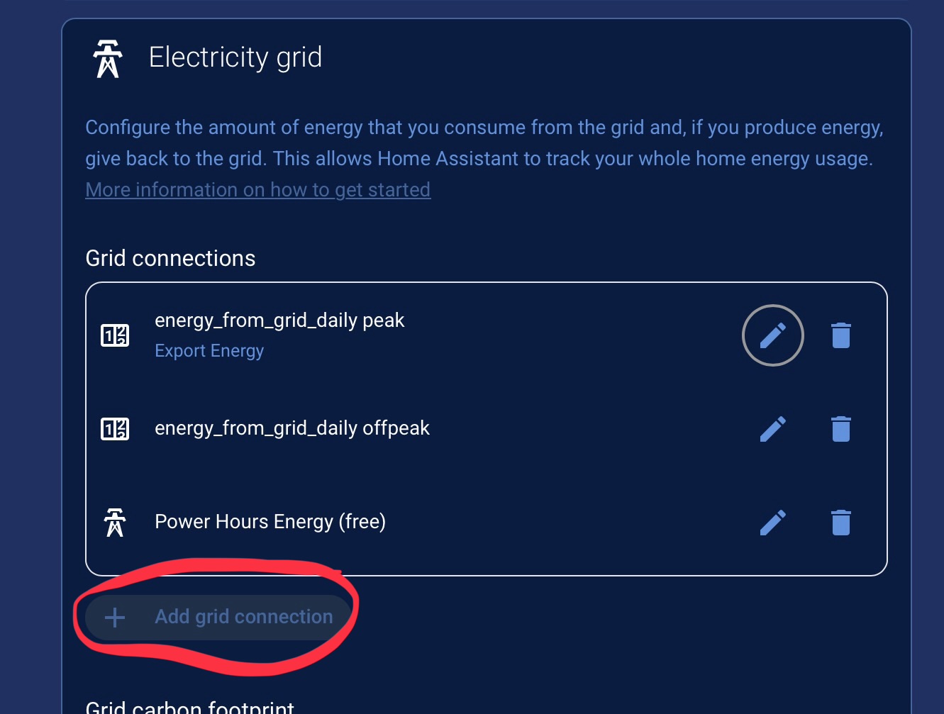

Add the two sensors using this:
Make sure each one goes here:
Buth both have the same "imported from grid":
