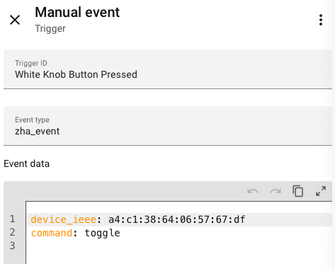

One piece of the puzzle that most probably already know but that I had to learn (so I’m mentioning it here in case others come across this thread in the future): the way to capture the correct triggers for an automation is to use Developer Tools to “listen” for it and copy the information from there. So, in my case, here’s what I did:
In the Home Assistant UI, go to Developer Tools > Events, and under “Listen to events”, type “zha_event” (at least for me, as I use ZHA). Then, interact with the device in the way that you want to capture as a trigger. In my case, that meant clicking the button on the knob. You should see something like “Event 1 fired X:XX” and some code describing what happened. The “data:” therein will give you critical data that you need to include in the automation. In my case, I was able to take the “device_ieee” and “command” fields over to the Automation UI and use them in a manual event trigger that looked like this:
or like this in YAML:
trigger: event
event_type: zha_event
event_data:
  device_ieee: a4:c1:38:64:06:57:67:df
  command: toggle
id: White Knob Button Pressed
alias: White knob button is pressed
So, I know have a working trigger that I can use to do half of what I want - that is, I can turn the lights group on and off by pressing the button on the device (knob). This is exciting progress (even though it’s probably pathetic to most HA veterans).
