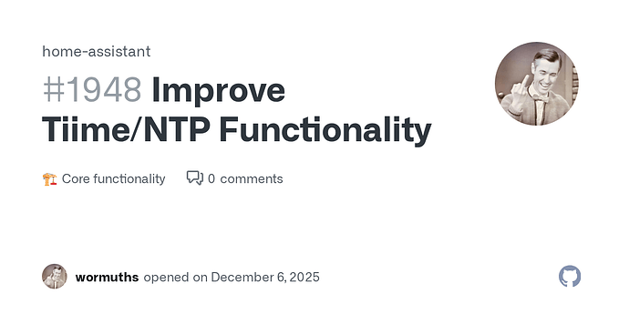

If you are requesting a change, the place to do that is here: home-assistant · Discussions · GitHub

I’ll mention it on GitHub as well.

thanks to whomever created the issue, small nitpick the issue title has an extra i
Me. Ooops.
