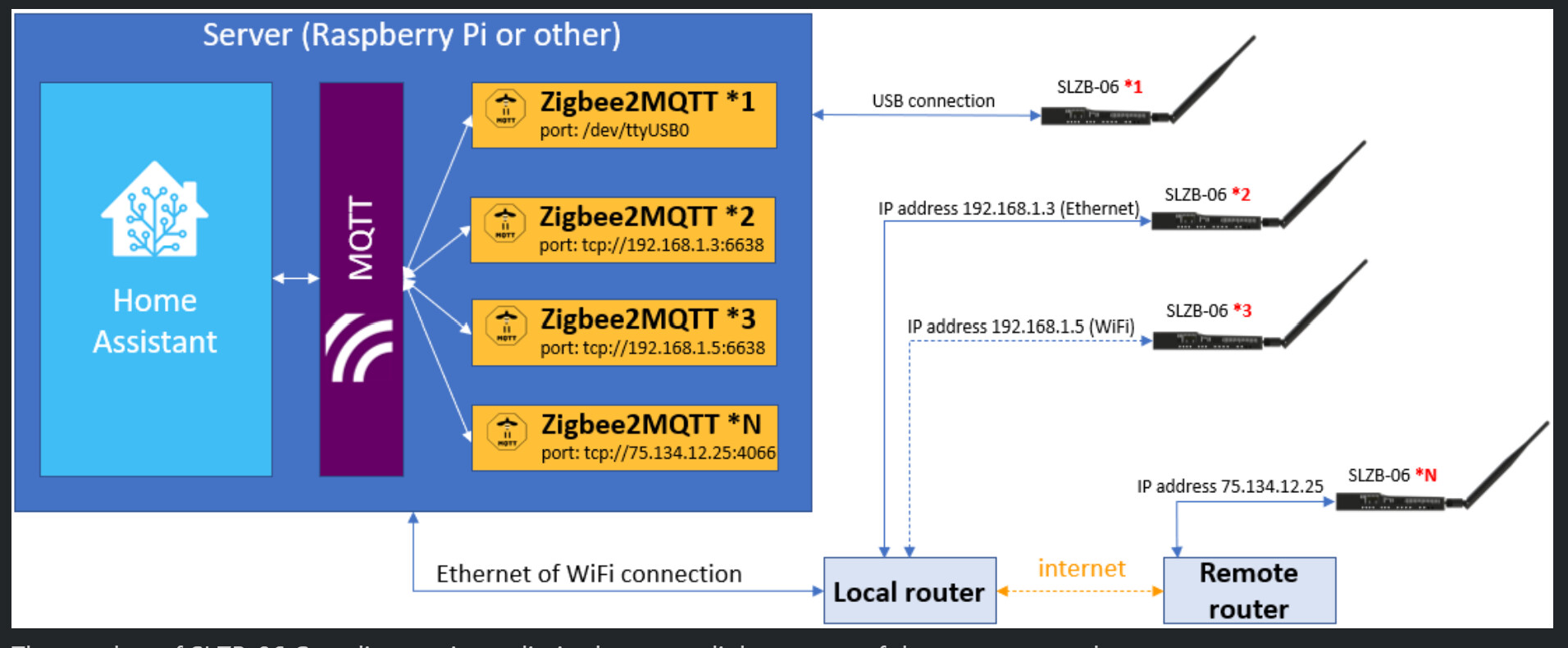

You can already do this without requiring additional Pis. Grab a few ethernet or PoE coordinators, hook them up in each floor and spin up multiple instances of Z2M.
You don’t need the url “hack” if you only need 2 networks - you can simply spin up Z2M Edge (the dev version that’s as stable & easy to set up as the main branch) and have it handle the second network. Hell, you could spin up ZHA and add a third network too.
The url “hack” is only required if you need more networks than that.

Yes, four RPis running Z2M each would solve the problem, however that’s quite an ugly solution since the Zigbee to MQTT translation could be done on the server side just as well, with PoE Zigbee adapters just acting as gateways for the Zigbee traffic. Which brings me back to my original point, Z2M is kinda bad…
You do know that you can just run multiple z2m containers on the same RPi, right? :man_facepalming:
