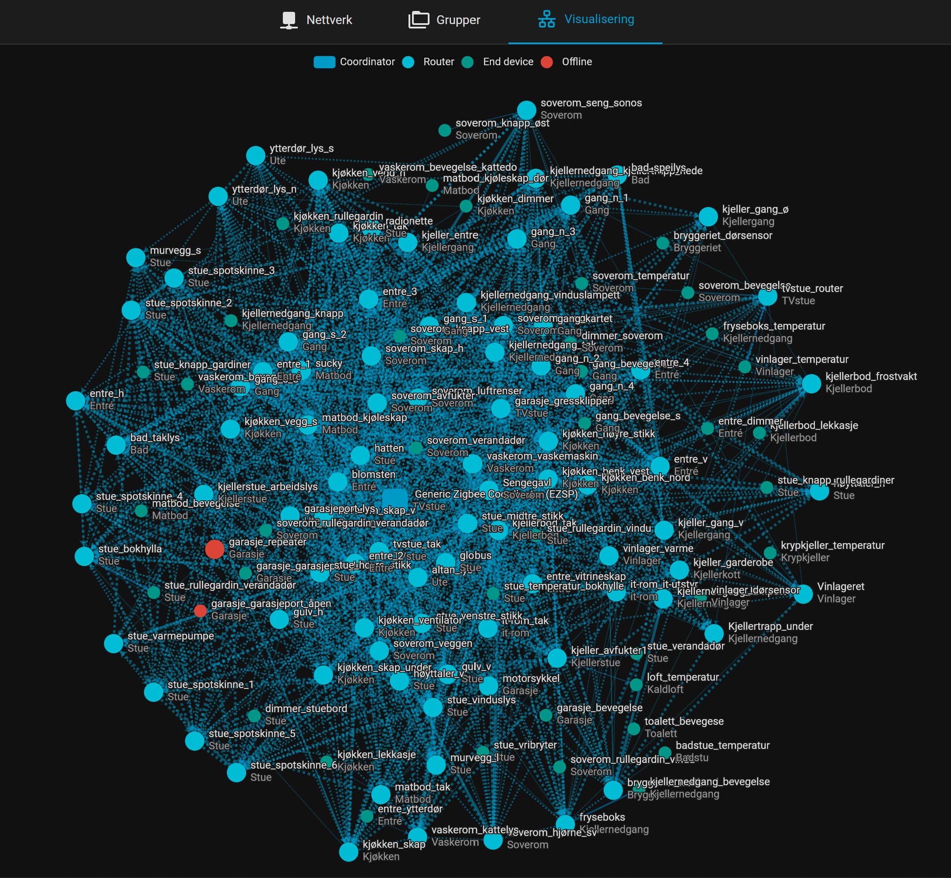

  • I’ve added a screnshot of the network visualization (just in case someone’s curious), the two devices offline are in my garage after flipping a fuse. They will probably be back tomorrow.
