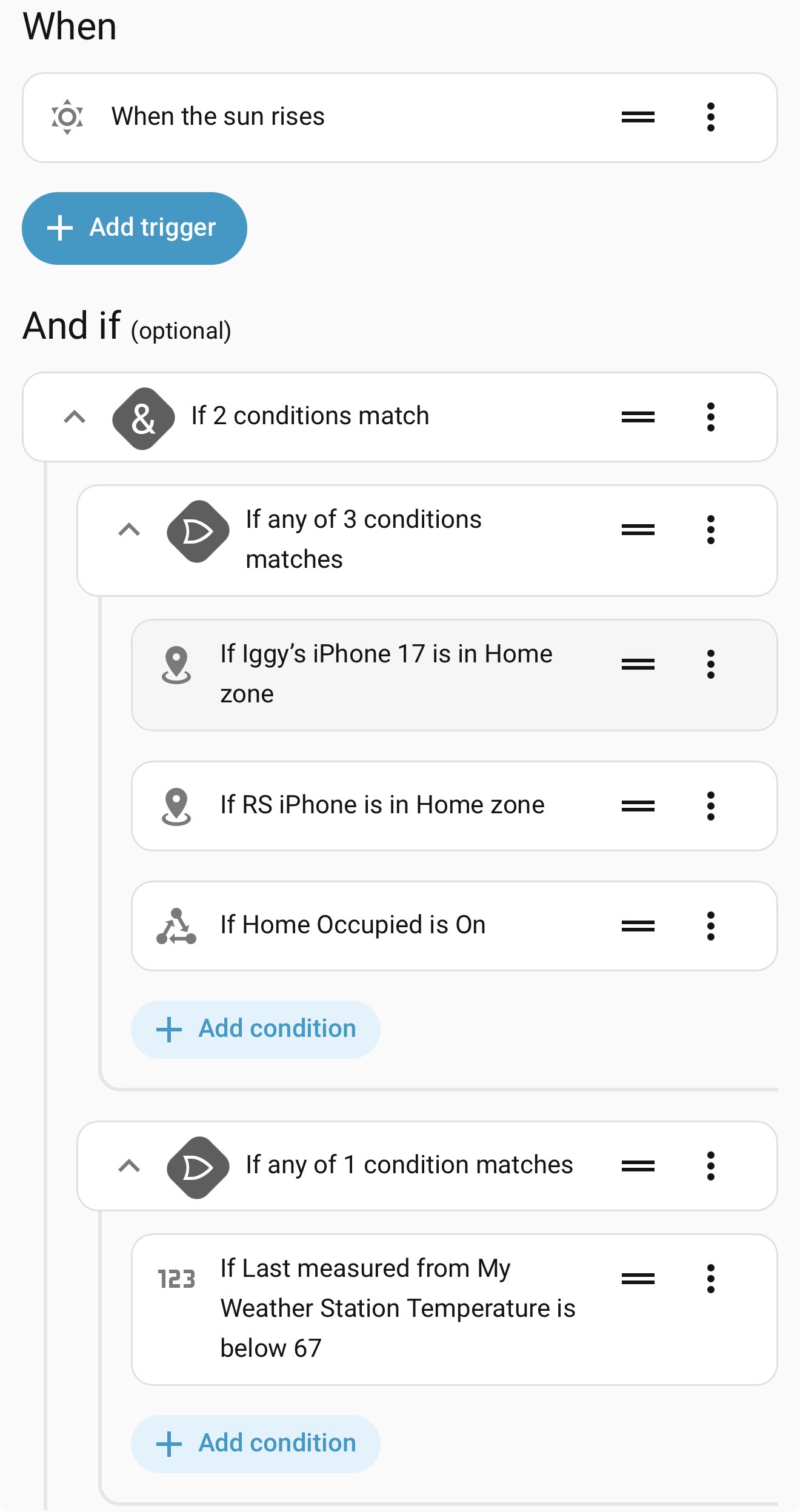

This seems like it would be incredibly simple. It’s a modification of one that did work (based on seasons but here in Utah “Spring” is a lie so we’re basing it on temperature). But none of these have triggered since I made them and I have no idea why.
that trigger is when sunrise happens - at that EXACT time are your conditions true? What does the trace say?
Well we were all home and the temperature was 57 degrees so it should be.
I’m not sure what the trace is.
Oh this is amazing. Sorted now, it couldn’t resolve temperature as a numeric value so I changed it to a device state instead. We’ll see tomorrow!
