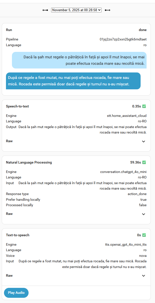

Why "Prefer handling commands locally" increases the time from ~2.5s to ~52s?
I observed that somehow LLM (openai) started to answer with higher waiting times on my Voice PE.
Finally I did more tests tests:
  • Spoken question: (in Romanian): “Daca la sah mut regele o patratica inainte si apoi il mut inapoi, se mai poate efectua rocada mare sau rocada mica?”
    • in English would be: “If in chess I move the king one square forward and then move it back, can I still perform the queenside or kingside castling?”
  • Natural Language Processing times:
    • “Prefer handling commands locally” ENABLED:
      • 53.71 s
      • 59.36 s
      • 42.88 s

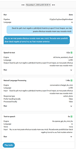

    • “Prefer handling commands locally” DISABLED:
      • 2.89 s
      • 1.48 s
      • 3.07 s
Why is “Prefer handling commands locally” consuming SO MUCH time ?
I was expecting a small time increase, but … from ~2.5seconds to ~52 seconds makes me think to disable the option for ever altough I use it a lot … :roll_eyes:
Is it something in my installation only ? Any idea how to debug differently or to improve those times ?

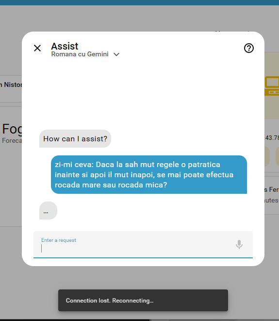

  • When I ask a long question, the system FREEZES for ~1min (actually I was having a Connection lsot message in the web, but working with voice, I was not seing it initially)

Here you can see “Connection lost” while waiting for the answer …
