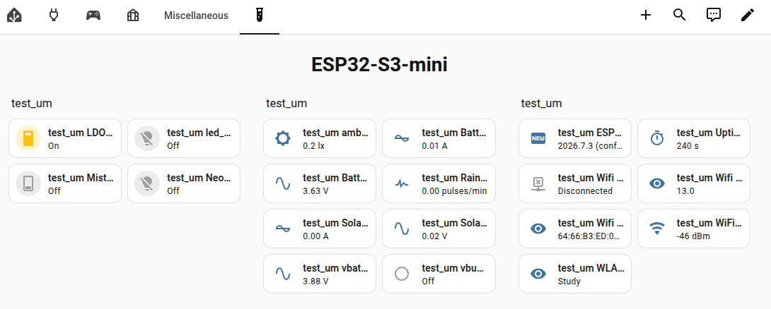

I just added my “test_um” ESPHome device to the dashboard using the user-friendly “Add to dashboard”. Colour me unimpressed.
For ghod’s sake, why use tiny boxes when the entity names are long, and all start with the same device name ???
I expect there is a way to adjust these entries to make them readable … one by one. No longer access to the yaml to do a quick cut/paste through the section. That’s one way to force users to set up their dashboards manually.

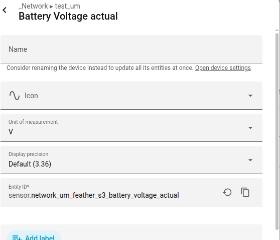

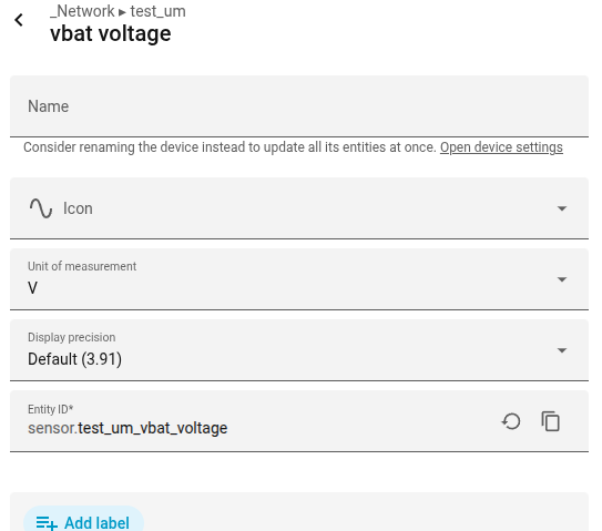

In Devices & Services, under the ESPHome Integration there is the “test_um” device which contains the list of Sensors including “vbat voltage”
So far, so good. But why does the Entity ID for Battery_voltage_actual include network name and a different device name ?

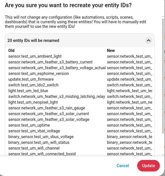

OK, well I have changed things around a bit while testing … but I can bring all the Entity IDs back to my consistent values. I choose “Recreate entity IDs” and list the 20 enities to be renamed and see
It seems that padding device names with area and device name is now compulsory, and again, why is this window sized so that it cuts off important information ?
I do accept that in a large installation, prefixing device names with the area is one valid naming convention … but does it really need to be compulsory ?
