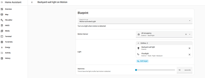

I forgot to show the picture. At the bottom I see 10 seconds set for turn off time. Isn’t that what should turn off the lights?

Blueprint means a custom thing added after to HaOS? It says by Home Assistant. I thought this camera with my fresh install. I guess not?
Below is the code for this that I see in automations.yaml. How to change it to make it turn off after 10 seconds of no motion?
