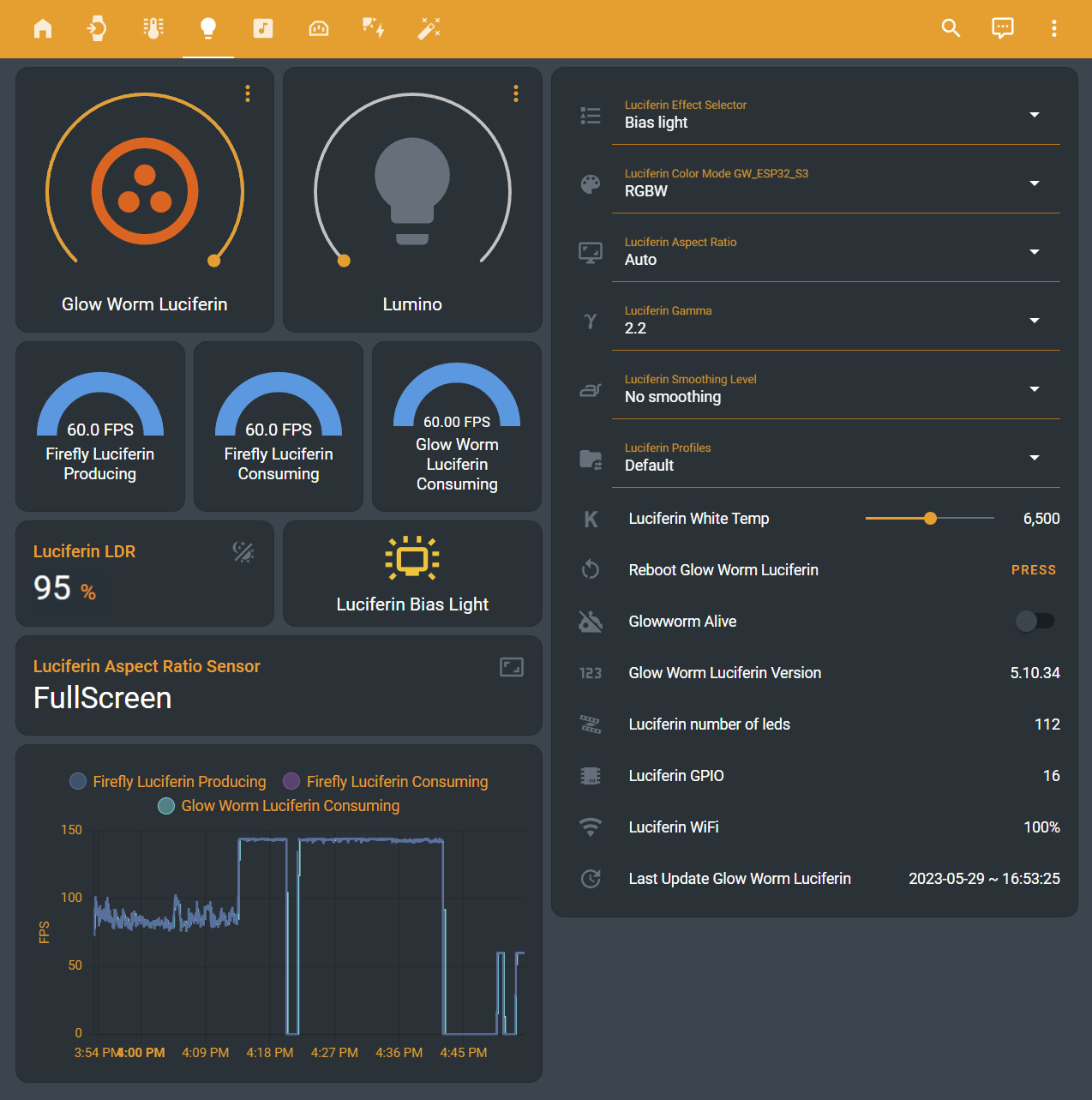

This theme is supposed to look like this:

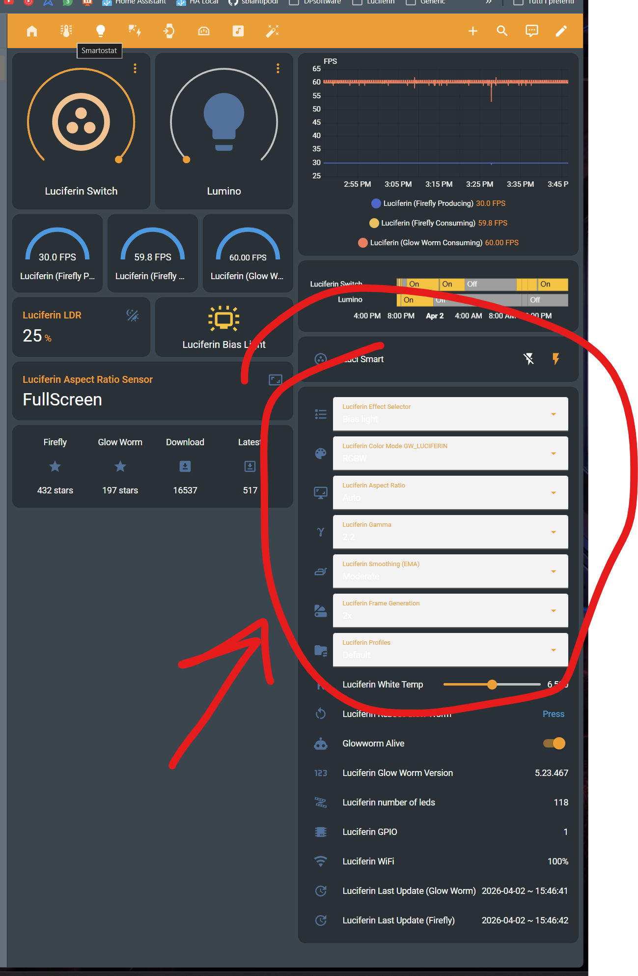

now it looks like this
as you can see the select are now white.
Why?

My light theme is fine but even after adjusting the theme options shown above I have an issue with my dark theme. When scrolling down a list of options the highlighted option under the cursor is bright white. I would have thought this was the hover option. It is not.

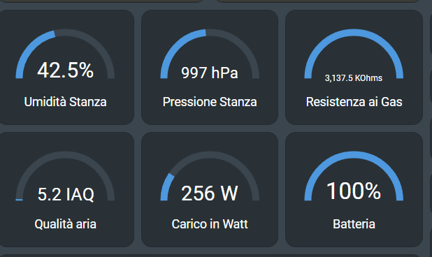

what happened to gauges now? O_o
they looks horrible now
I didn’t noticed it before…
I don’t like them either (yet), have changed them to gauge card pro and configured it so they look the same as before.

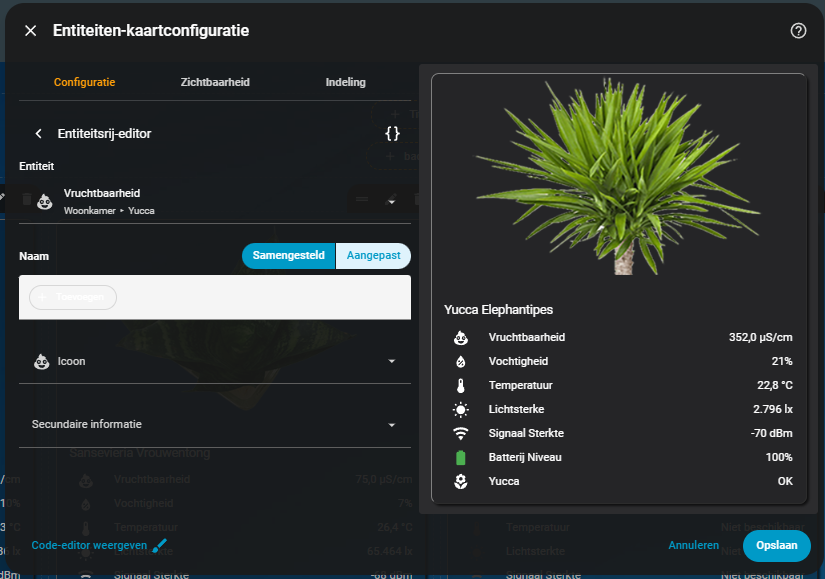

that helped me out out…unless 2 tiny things i can’t find
1 =
1
the text is black…should be white (not solved yet)
2=
that background is till white! should be transparent…

Both are the Entity cards…
The first one is an added entity and the name is in black…
How odd…
The second one is when ill edit an entity to add a name…
The pic i showed has no name yet…and ill suspect
That’s why it is white…
Thenk you Krivatri…
ok, then it should be the mdc ones I provided.
I use them too and the background is not white when no name is entered.
Ohhhh yeah!
Second 1 is fixed indeed by using
mdc-text-field-fill-color: transparent
Rock on Krivatri :upside_down_face: :ok_hand:
The First issue i just tackled aswell
mdc-select-label-ink-color: white
That did the trick!
